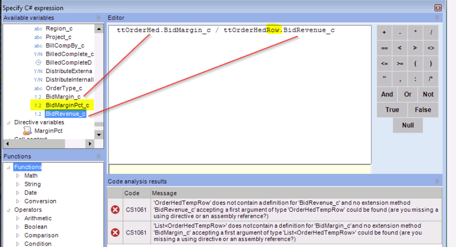

I can add standard fields. But even other UD fileds (ones added years ago) give me the same error.
What if you assign those fields to BPM variables first, then try to do the math with the variables instead of the fields directly?

Same thing. Get the “OrderHed TempRow does not conatins …” error
@dhewi - I’m in the process of re-regenerating the data model. I’ll try that after it’s done.

assuming your ttOrderHed.BidMarginPct_c is decimal type then i suggest to
remove the word ‘Row’ from the BidRevenue_c field name manually and see
also i suggest to do a simple math validation to avoid division over ‘zero’, this is a mathematical undefined value (Error), something like
if(ttOrderHed.BidRevenue_c = 0 then BidMarginPct_c = 0* or 100* else ttOrderHed.BidMargin_c/ttOrderHed.BidRevenue_c)

I found a solution. EDIT - even though someone had already posted it
Contrary to the info in a guide that support sent me “Epicor ERP C# Programming Guide (conversion from ABL ) 10.1”
Point 3 should have worked. But gives me my original error.
Point 4, which says is for Method Directives, does work. I ended up using
ttOrderHedRow.UDField<System.Decimal>("BidMargin_c")
Note I did have to include ‘Row’ in the tt table name.

I suspect the difference is not so much between types of directive, but whether you’re operating on a ttTable or a ttTableRow, and that isn’t necessarily very obvious within any given directive - does that make sense to you as a possibility? Where I’ve had to use this syntax particularly has been in updateable BAQs where rows are typically dealt with one by one and it’s the Epicor pattern, and noticing the ttOrderHedRow in your code made me think of that.
