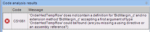

But I can’t seem to do a simple Set Filed widget. I’m trying to set the field BidMarginPct. But the expression gives me the following error:

I couldn’t even assign a variable the value of ttOrderHed.BidMargin_c
Same “OrderHed TempRow does not conatins …” error

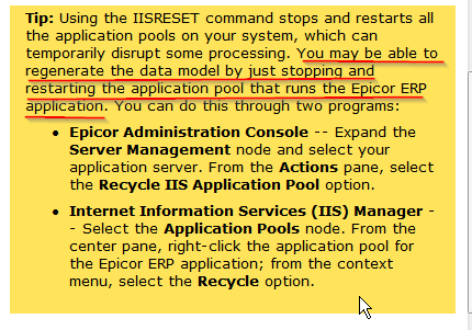

I think I may be a victim of only cycling the ISS for the specific App (my test environment), instead of the IISRESET

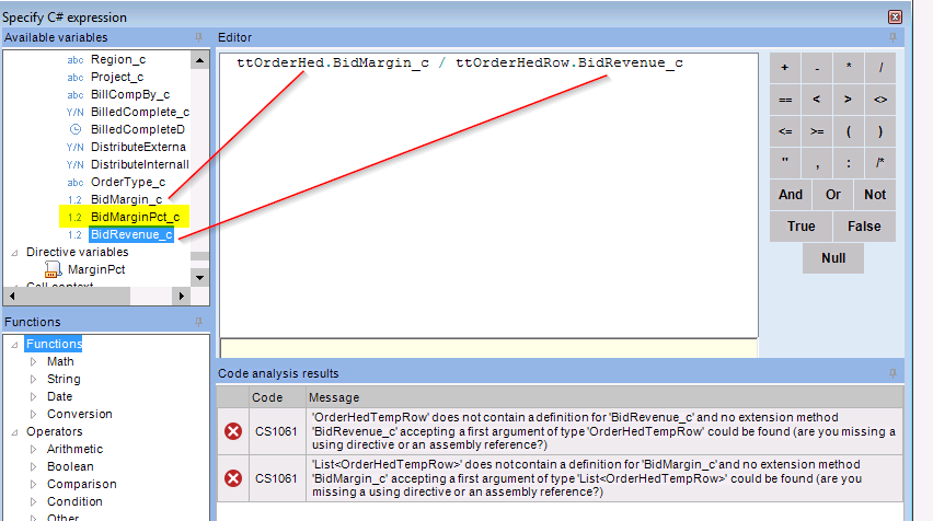

Just setting the expression to:
ttOrderHedRow.BidMargin_c
yields
EDIT: that expression is what I get by double clicking the field in the Available Variables pane.
Hmm, so you added the field in Extended UD Table Maintenance, regenerated the data model, and then recycled IIS correct?
Yes. but by “Recycled” I did it in the EAC. Not via ISSRESET on a command line.
From the help:
Emphasis on “May be able to” …
I would have interpreted that as the compiler not knowing the type of the field, but you probably know better than I do. In which case I’m out of ideas, sorry! I’ve yet to have all three versions fail.
It is certainly very odd that the editor allows you to select those fields and then still complains. The fact that they’re showing up surely means that the data model regeneration has done its job? We’ve never had to do an IISRESET for that, though now we have more than one app server we do have to do it in both.

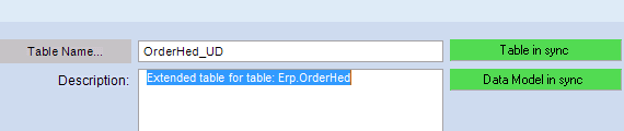

In extended table maintenance, does it show that the OrderHed table is in sync?
Yup
