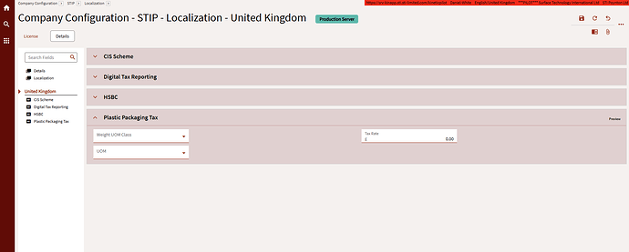

The CSF we are using for 2025.1.6 when installed does not include the Packaging Information in Company Configuration > Localisation
This is how we have it looking
The plastic Packaging Tax has been replaced with Packaging Information which has a section on EPR. In that it has a tick box that is defaulted to true :roll_eyes: which means when you do a shipment you have to enter a load of packaging details before you can ship.
Should look like this now

So is it a case the layer is just missing or there other stuff related to that functionality missing… I am surprised it is so broken
Not 100% sure as the DB information is there and i can see the field in the DB that controls the EPR details. Support are aware of the issue as they have said it is fixed in 2025.2, i am just banging my head against a wall at the moment trying to get the hotfix out of them.
The worrying thing i have found is that if i set the Enable EPR off via the DB then i cannot even create Customer Shipments as the + is missing from the Customer Shipment screen :zany_face:
