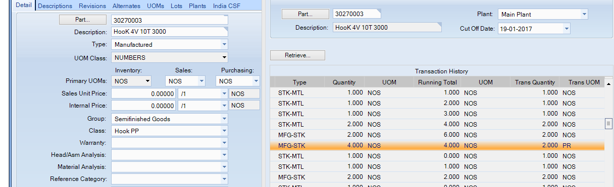

An user has faced an unexpected error in part transaction history while he make Job receipt to inventory.
he received 4 NOS in stock from a Job, and part received in 2 PR (Pair) UOM. ,where PR UOM not assigned to Sales,Purchase and Inventory.

Track lots for this part is enabled, so it can be tracked multiple UOMs, but while making MFG to STOCK entry it doesn’t allowed PR UOM.

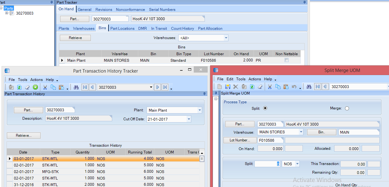

If we ignore this transaction, when i have tried the 2nd solution you have advised, the part tracker shows 2 qty of PR UOM in hands In MAIN warehouse and MAIN bin . I want to split it into 4 NOS. But when i selects that warehouse and bin , LOT it doesn’t shows on hand qty…its shocking …bcoz parttran history shows 4 NOS running qty in MAIN warehouse.
attaching the screenshot…
Thanks…
Is that the correct lot number? These screens with bins and lot numbers are touchy; you have to search in the right order to find the valid lot for the bin. I forget if it’s the lot that has to be picked first or the bin, but if you pick in the wrong order you’ll end up with an invalid lot/bin combination, and therefore 0 of that lot in that bin. I think I created a customization to help with the bug but I don’t remember…

I have tested all the aspects u had advised, at the Split/Merge screen it shows 0 Onhand qty. It might happened bcoz its primary UOM is NOS. So for 2 PR it doesnt show onHandQty for NOS.
