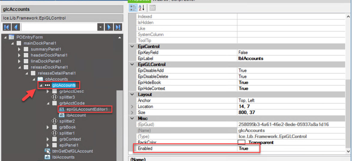

I cannot do anything with this Control’s properties. Even if I set “Enabled = True”. It will let me change a property but I move off it, then it puts it right back the way it was.

I had figured this out, I had to go up to the parent control called EpiGLControl and set Enabled = True. Then I go down to the child controls like the EpiGLAccountEditor and change the properties.
