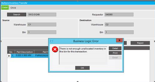

Hi everyone,
Anyone i get the below error message when click approve.
On hand qty has sufficient qty to transfer.
Hi everyone,
Run the Time Phase Material on tbat part to see what demand exists. That might be driving the allocations. If you dont see any run the processes to rebuild the bin qtys and allocations. They’re in Rebuild Process in System Maint (I think)
Hi Shantanu,
We have had parts that were buy to order and received into inventory get “allocated” like this… even though we don’t purposefully use any allocations.
In order to free it up so we could move it about, we closed and reopened sales order release and this freed it up (in prior version of Epicor… hopefully still works IF this is your difficulty).
