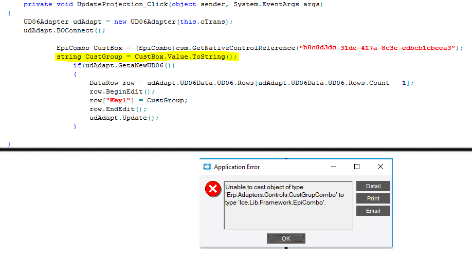

Hey All,
I am attempting to grab the value out of a combo (dropdown) that contains the customer group, but keep getting a cast error. If anyone has any ideas on what I’m doing wrong and could tell me that would be awesome. Thanks!

Change
EpiCombo CustBox = (EpiCombo)csm....
to
Erp.Adapters.Controls.CustGrupCombo CustBox = (Erp.Adapters.Controls.CustGrupCombo)csm...

Awesome, that did it. Thanks for the help.
