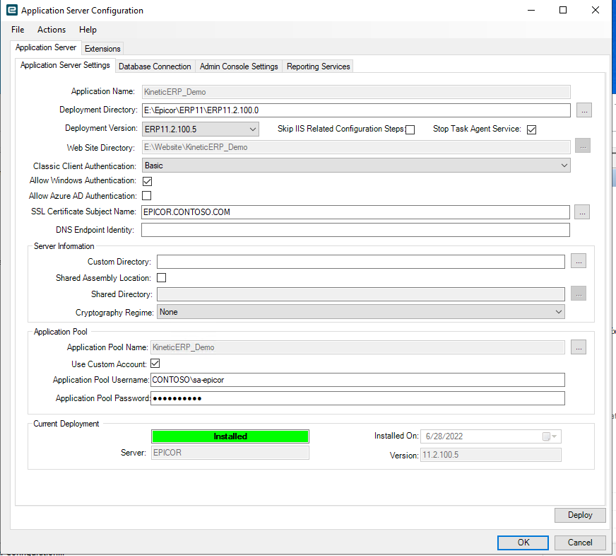

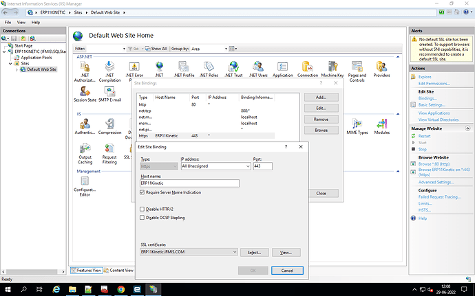

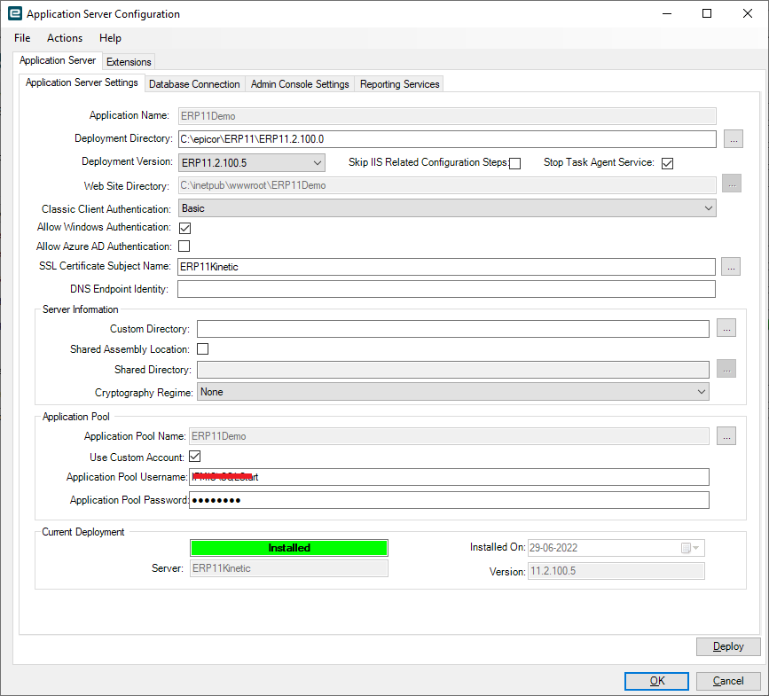

Its tough to diagnose there could be so many reasons.
We would need screenshots from your Admin Console, Admin Settings, IIS Settings, SSL Cert, Binding Settings…
