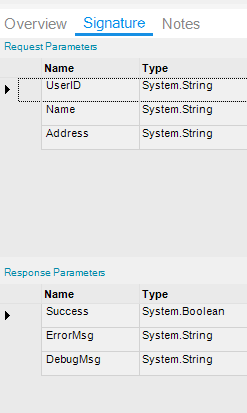

Here @Hari_Dutt
Dropped in a function:
HariDutt.efxb (1.9 KB)
try
    CallService<Ice.Contracts.UserFileSvcContract>(svcUF =>
        Ice.Tablesets.UserFileTableset ds = new Ice.Tablesets.UserFileTableset();
        svcUF.GetNewUserFile(ref ds);
        var newUser = ds.UserFile.FirstOrDefault();
        newUser.UserID   = UserID;
        newUser.Name     = Name;
        newUser.Address1 = Address;
        svcUF.Update(ref ds);
        DebugMsg = ds.UserFile.FirstOrDefault().Name;
    Success = true;
catch (Exception ex)
    Success = false;
    ErrorMsg = ex.Message;
Payload:
  "UserID": "Test3",
  "Name": "Test3",
  "Address": "1235 Butt Street"
Output:
//Submit first pass
  "Success": true,
  "ErrorMsg": null,
  "DebugMsg": "Test3"
//Submit second pass (duplicate / error)
  "Success": false,
  "ErrorMsg": "This is a duplicate entry of an existing record.",
  "DebugMsg": null
