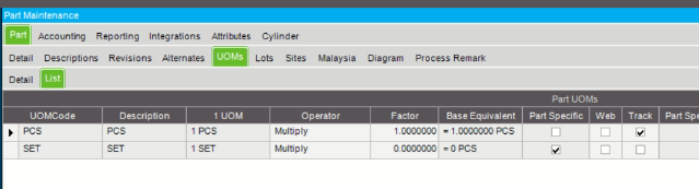

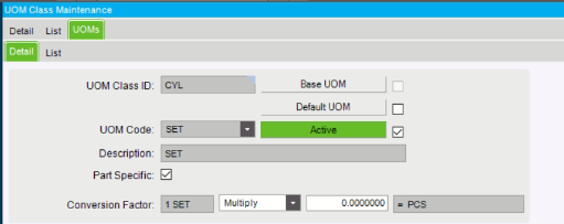

Hi, Below is the setting for this part.

I see that the error seems correct based on the setup, however I know very little about UOMs to give you any feedback or possible workaround, my advise would be to contact support so it can be investigated.
I think you’re going to have to make a part specific UOM for each set qty
(1) SET1 = (1) PC
(1) SET2 = (2) PC
(1) SET3 = (3) PC
And so on …
