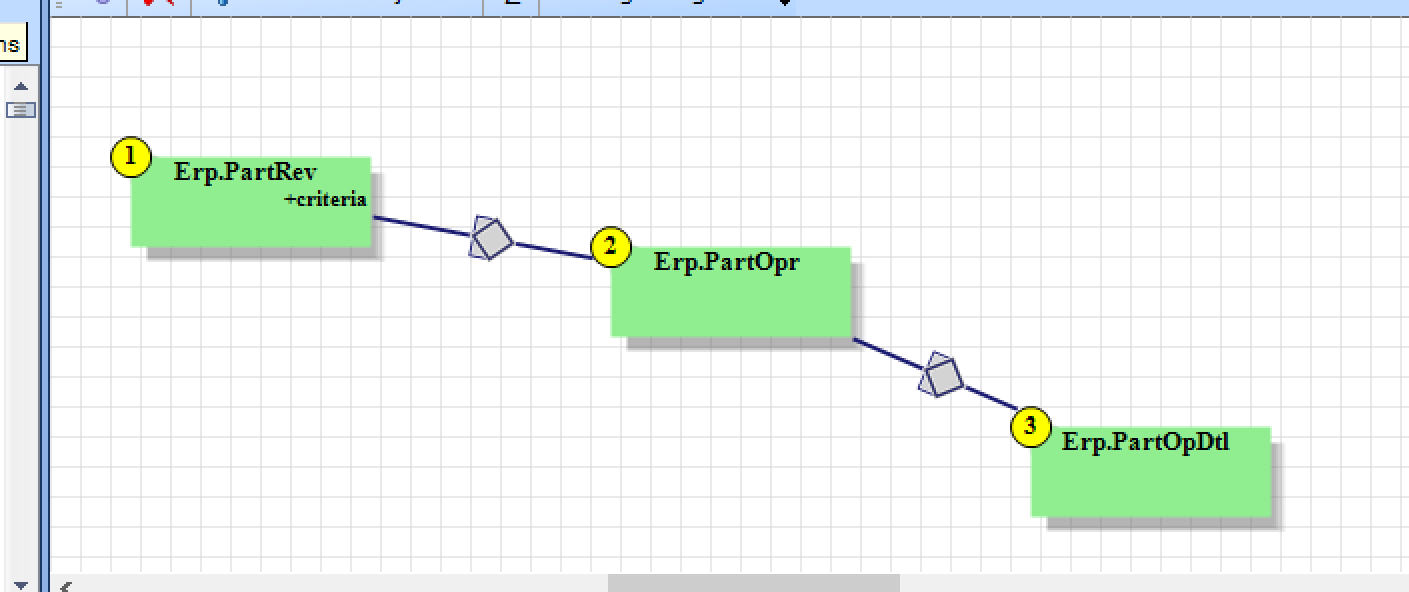

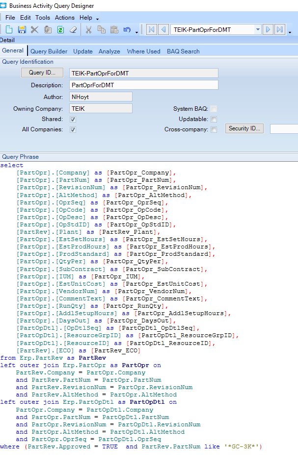

Wow ~ you have a whole lotta fields in that DMT! I prefer to make a query of BOO that I have in system acceptably and then download only the fields I need to update in the DMT. The more unnecessary fields in the DMT, the greater the risk of putting something in there that causes error in my opinion.

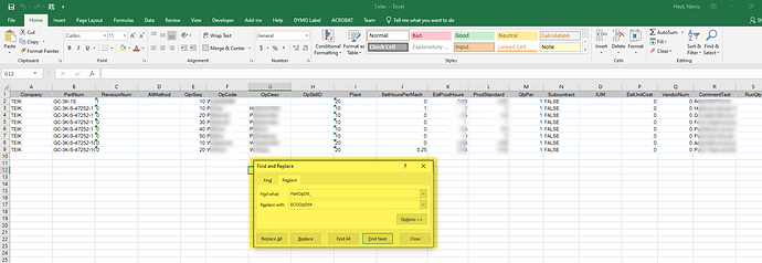

Here’s a BAQ I use when downloading a BOO out and then editing it for current need and DMTing new BOO in. It might help you whittle down your fields. Also, BAQ doesn’t like ECOOpDtl# as a field alias, so after I download the BAQ data, I do a find and replace on the field name.
Hope this helps!

TEIK-PartOprForDMT.baq (23.8 KB)
Thanks a lot , yeah I am going to try to remove some fields , basically I use sql and export every field from ECOOpr and a few fields from ECOOpDtl ,the dmt template provided those, but I think you are right. I’ll try this to remove the ones that i dont need.
