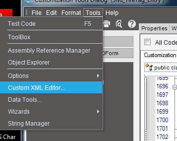

I would go to Custom XML Editor, then there will be 3 tabs, on 3rd you should find your Hide Property - just find it and hilight it, then press Delete on your Keyboard. Save your Customization, Close Screen, Open Screen.
2018-11-15_1539
If that doesn’t work, then perhaps its on a Personalization Level.

Thanks a lot, worked like a charm after closing and opening the customization again.
