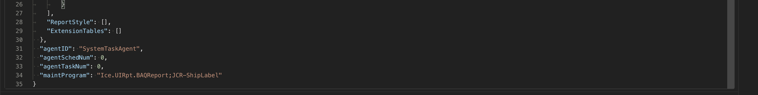

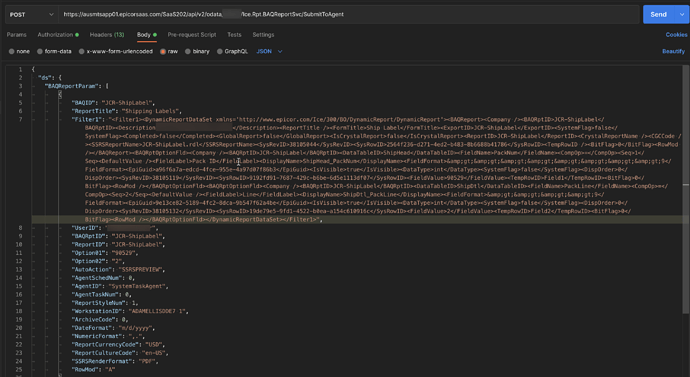

Utah, not sure if you are still looking into this but I had to work on this for somebody and got something to work. This call does a print preview and pops up on my workstation but should work for printing or whatever else you might be looking to do:
Adam thank you for posting this! I am not working on that anymore, but I still will need it in the future.
At insights I learned how to use the business objects to print a report via a function as well so I was going to go that route too!
