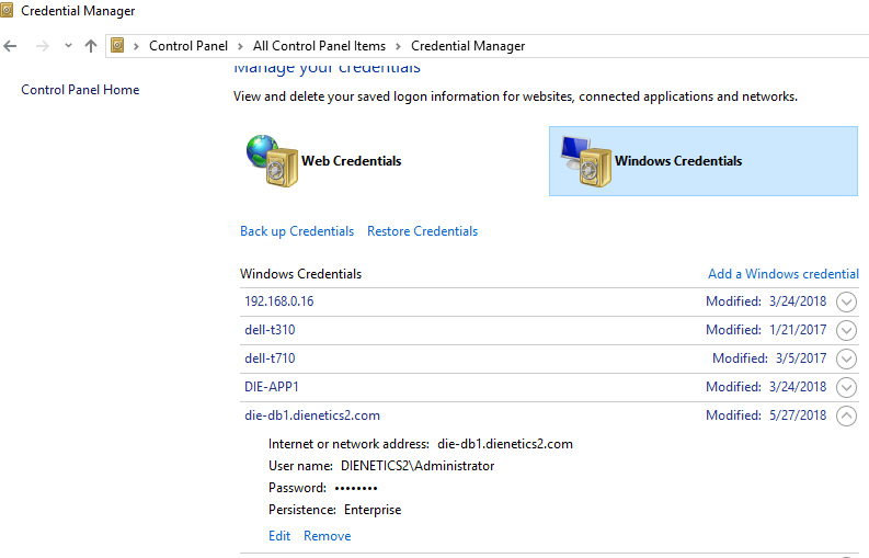

You might have to set your User Credentials to the full Server via Control Panel so windows resolves it properly, especially if you are not part of their Domain.
Mr. Hasokeric: I rebooted my VM and I can connect up now.
Thanks for the suggestion - did not think of looking at the Credential Manager - I will in the future.

I seem to be having the same trouble - It looks like I got the client to install but when I log in - it just says ‘Attempting to reconnect to the server’
I see the user credentials - but not sure how to populate - Mine does show a user credential for my server - to I need another to the \server\share??? of some sort or?
