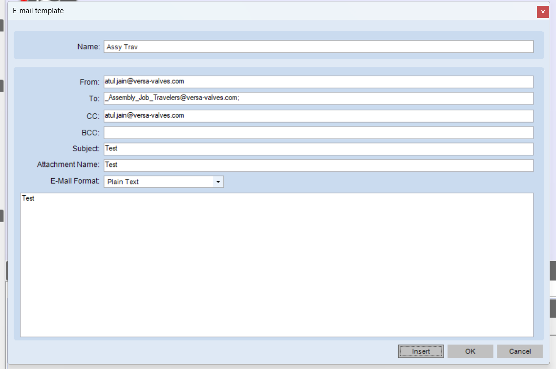

I am trying to make use of APR to send email to our groups in the system.
It goes out to an individual, but it doesn’t go to all the people in a group.

Also, the log shows email was sent:

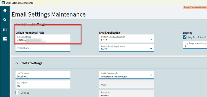

In actual fact, looking at the screen shot. I think that your mail server is probably rejecting it because the from address does not match with the email address setup in your email settings.

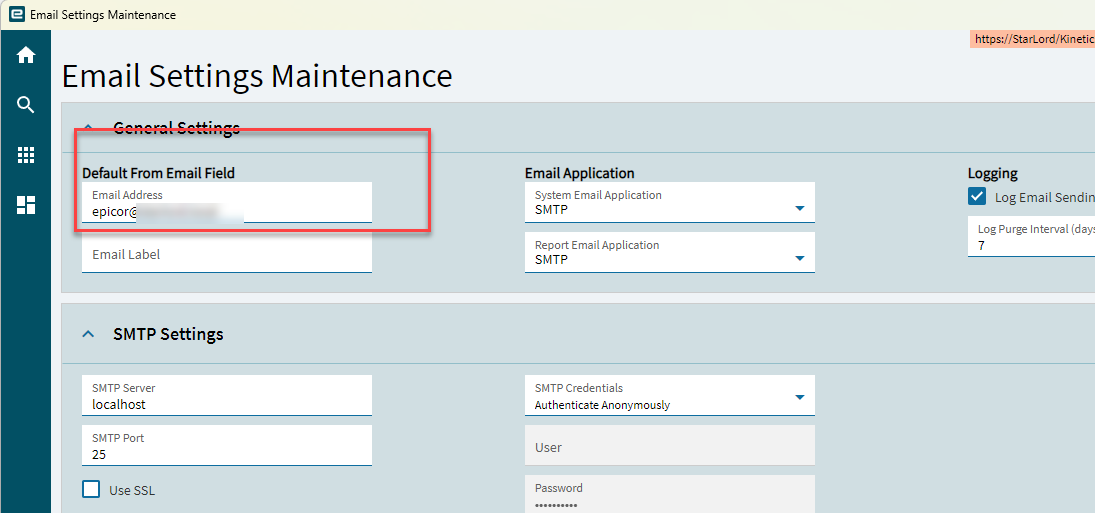

Here is a screenshot.
This may not solve your problem. I know I have emails going out with a different from address than the one configured and they work… Once again this probably being controlled by your upstream email server or SPAM filtering.
Delegation/send-as rights? In your case you have SMTP localhost and authenticate anonymously…but if he’s got an explicit username in the email settings, maybe that’s conflicting…

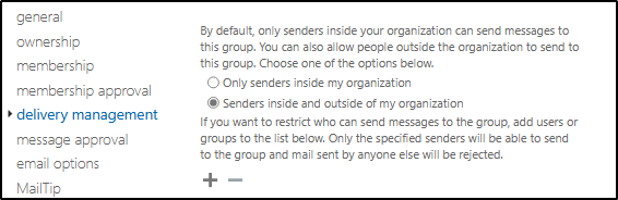

Sometimes group e-mails are created with restrictions on who can use them. Depending on how you have configured your e-mail connection in Kinetic, the message may be seen as coming from an unauthorized source.
If this is a new group just created check this setting on the group in the email server. It may be being seen as an outside email.
