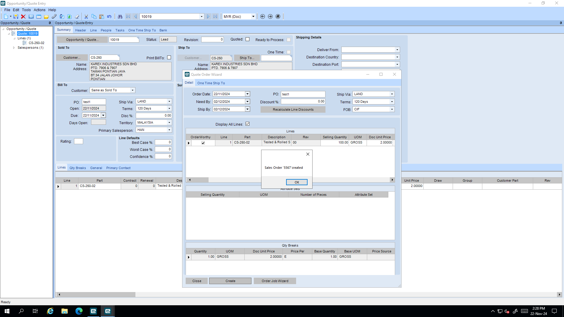

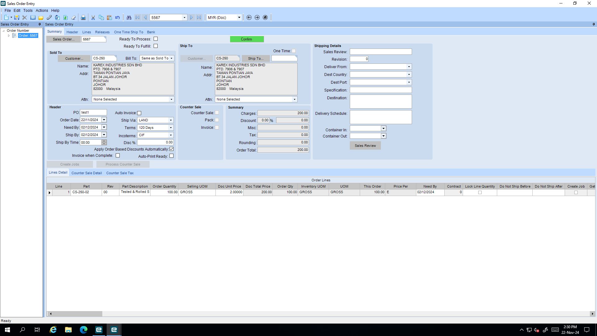

Sorry for late reply. yes SO created from Quote. i try to run a test mail, i can receive the test mail, and even email receive when SO created directly from order entry.
Hi Bruce,
yes. this is ok. from CreateOrder no problem. only when SO created from quote no email send out.

i managed to trace it from quote to order. but i don’t know where should it look for in the trace file to accomplish my task.

Thank you very much, the business object is BO.Quote.CreateOder.
i managed to fire the email when the SO is created from quote.
Right now, it look like from BO quote.CreateOrderFromQuote that I try, how to get to know which other BO to accomplish this send email? I really do not know how to trace this. Hope somebody can help.
