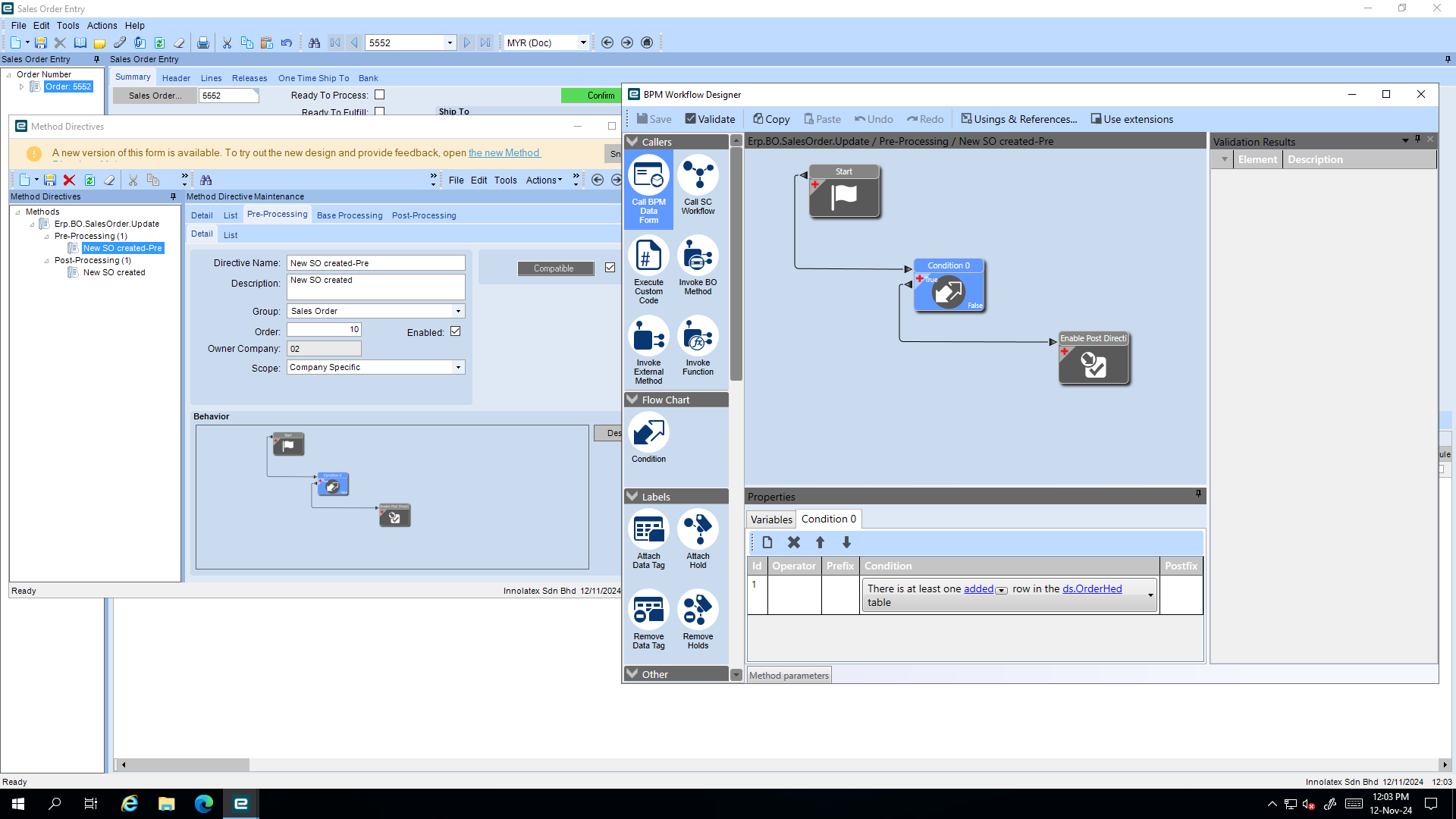

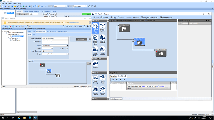

i try to create a BPM to trigger email to user whenever a new SO is created. i am able to trigger the email whenever SO is created from order entry screen directly. However, the email is not trigger when the SO is converted from quote. Can anybody guide me how to create BPM to trigger email whenever the SO is created from quote?
Below is my BPM that successfully trigger email when SO is directly created from order entry menu.

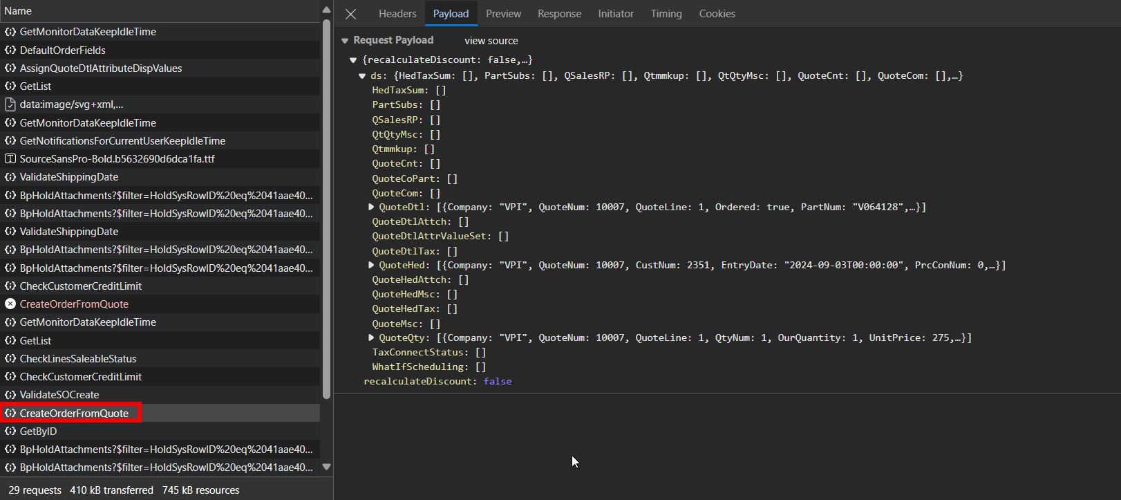

These are the steps I have from an Epicor employee on how to set up trace on the desktop client. I imagine this would work for you as well. I am on SAAS, but I imagine the desktop client is the same. It is kind of annoying because it will open the trace screen every time you click into a new screen, but at least you can see what methods are being run and what data is being passed into those Methods to look for a condition to send an email

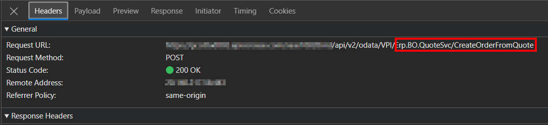

I just converted a Quote to a Sales Order (Kinetic view though) and it seems to run a method ‘CreateOrderFromQuote’
For a method directive, you’ll probably be looking in the Quote table, CreateOrderFromQuote method

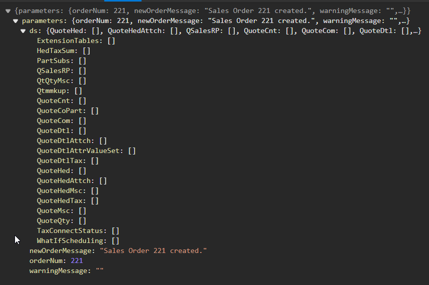

Do you think we can hop off of this? This is in the preview of the CreateOrderFromQuote method. 221 is the Sales Order that was created.

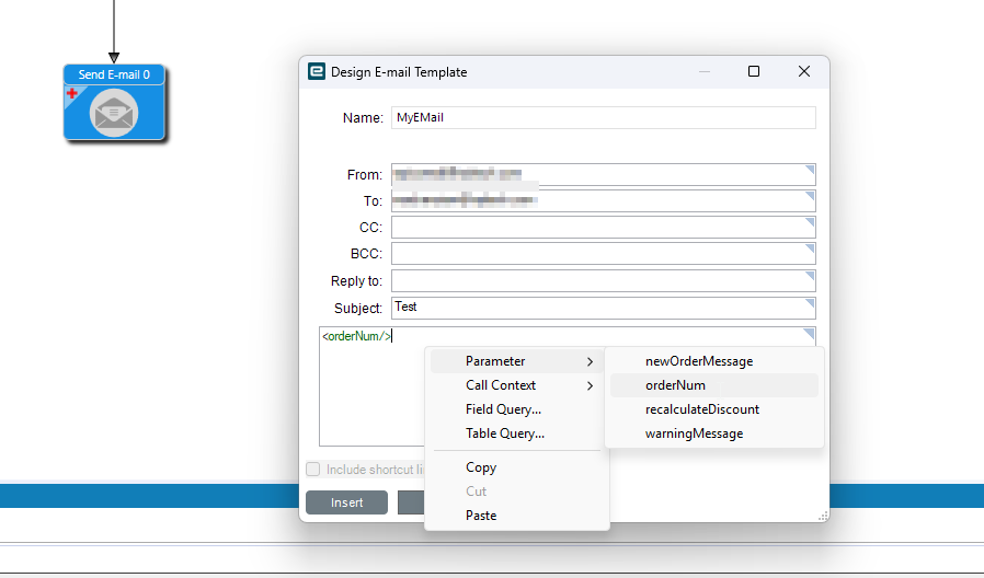

You can get the OrderNum in PostProcessing. In the Email template, you can call Parameters > OrderNum. This is has to be run as a Post Processing directive because OrderNum doesn’t exist until after the Create method has finished.

the email template i know how to draft it, but i do not know what to test in the BPM before triggering the send email.
meaning:
Start ---- ? ----- send email (i believe there must be a condition to test before the action send email)

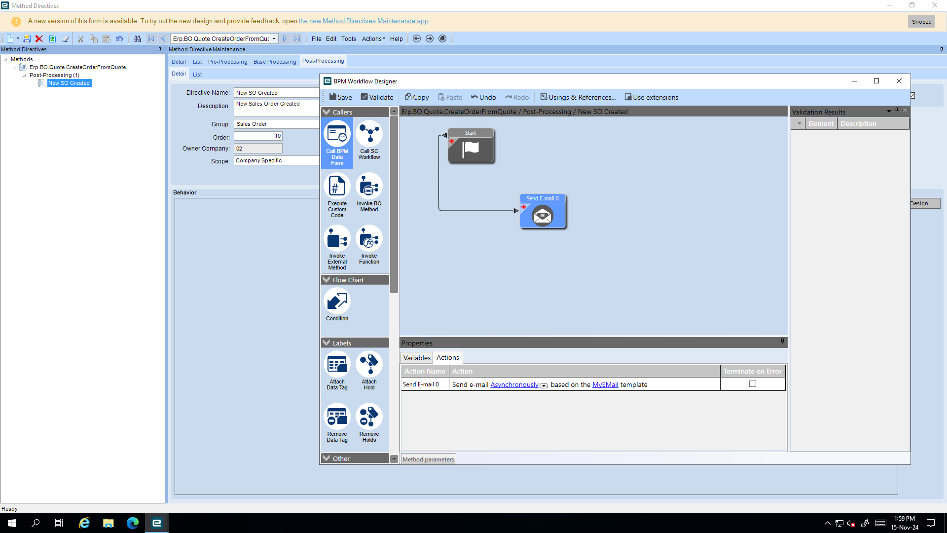

method: BO.CreateOrderFromQuote and post-processing.
Why couldn’t it run with no condition, the condition is CreateOrderFromQuote has run. Click create new post-processing directive on that method and just drag the Send Email widget in there and structure your template?
I asked what you need to email because on post processing you’re pretty restricted on the data you have after it runs, but you can leverage more widgets to go look up that data for the email.
Hi Mackenziem,
i create the BPM based on your advice without using any condition to trigger the email, but it did not trigger email when i run the test from quote entry. Attached is my BPM.

Did you verify the Sales Order was created? When I ran through the same process, I got the email, same way you have it set up.
