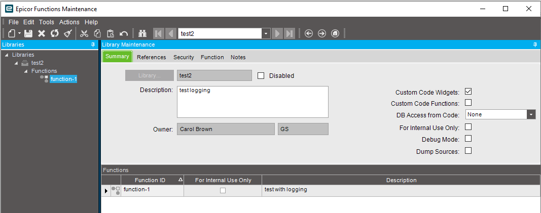

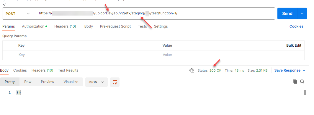

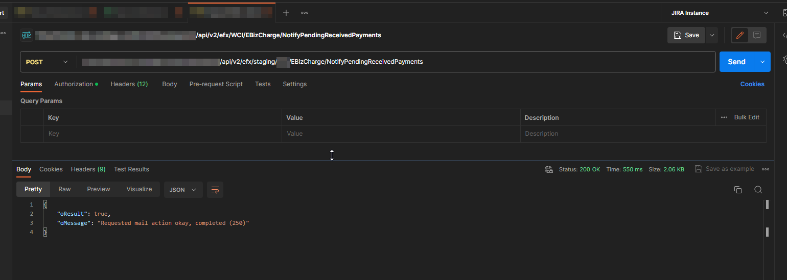

Good morning. Hoping someone has some insights on this issue we are experiencing. Per Epicor documentation:

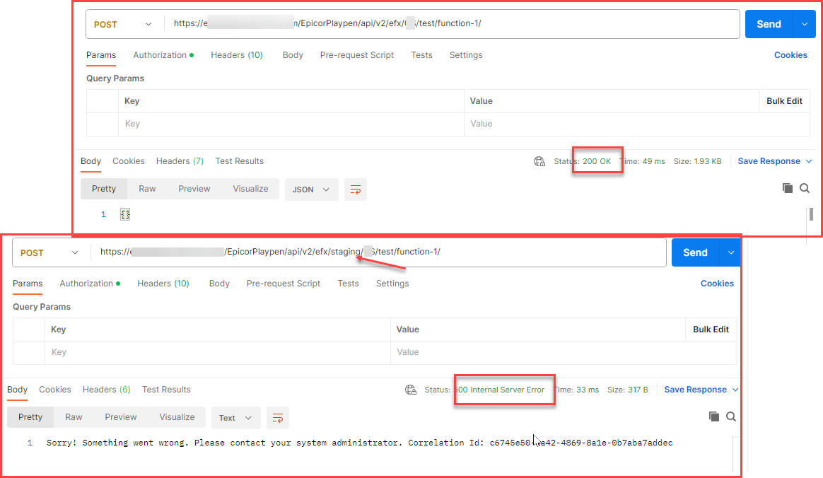

An unpublished library, meaning a new library that contains functions that are still under development or a previously published library that has been demoted from production for an update, can still be called via REST by developers for testing purposes. To do this, use a special staging segment in the request URL:
https://[KineticServer]/[KineticInstance]/api/v2/efx/staging/[Company]/[Library]/[Function]/

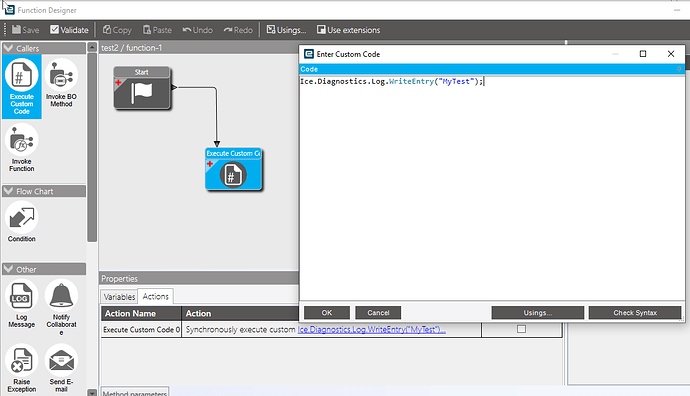

This works as documented in 2022.1.13. It does not work in 2023.1 or 2023.2. Using Postman to test the unpublished function, I get an error 500. The logging on the server is System.ArgumentOutOfRangeException: Length cannot be less than zero. (Parameter ‘length’)

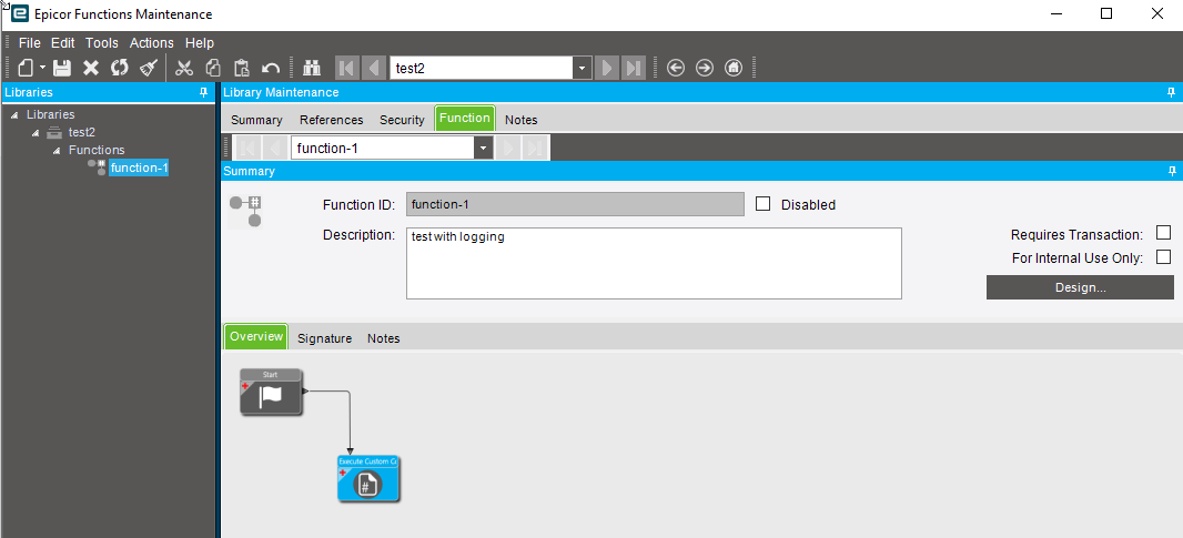

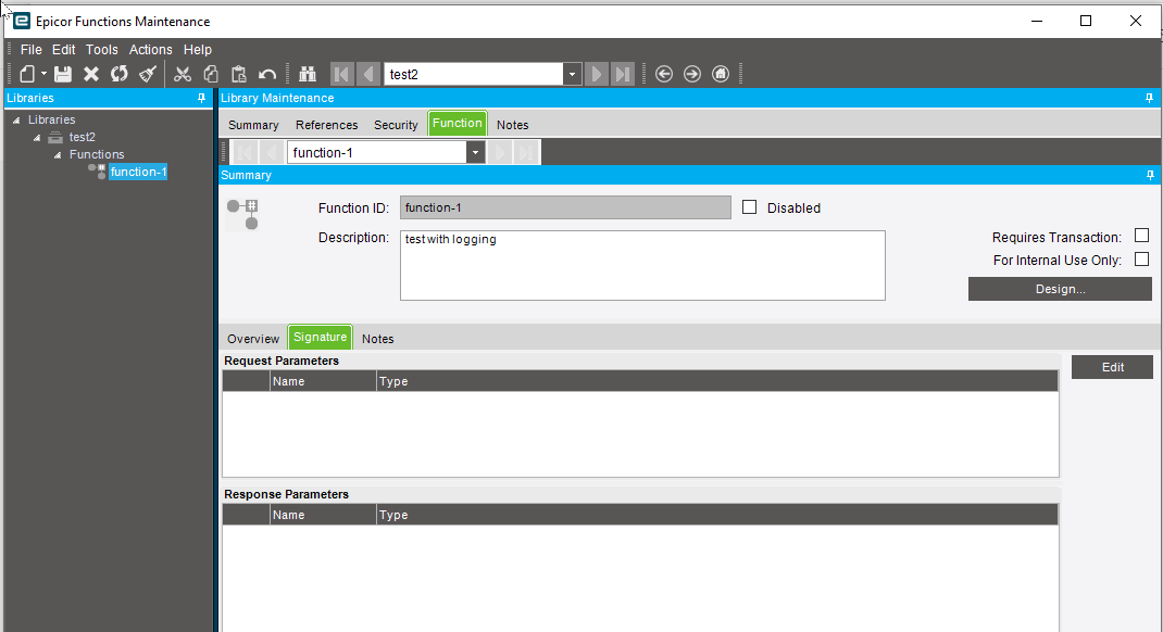

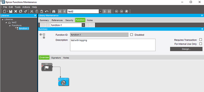

I have tried a function with parms and a totally blank function with no parms and the error message is the same.
