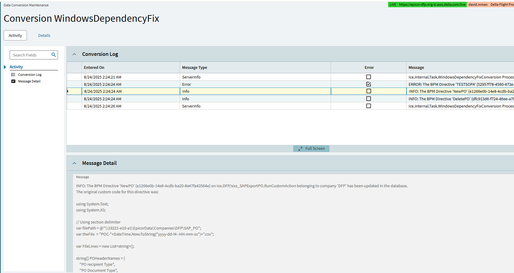

We’re currently working on updating to 2025.1 and I came across this same thing through reviewing Conversion Workbench processes that had issues. Not sure if it’s new or not, but the program “WindowsDependecyFix” did the same for us. If you click (in Kinetic) on the conversion name, it opens up a window that you can see the activity it did. I filtered on the Message column for Does Not Contain “no code” to show me the ones that have code and discovered exactly what you posted here. The Message Detail card will show you the previous code prior to the program updating it.
