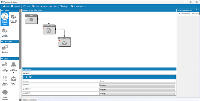

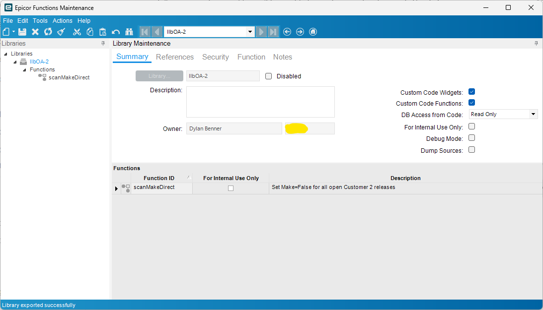

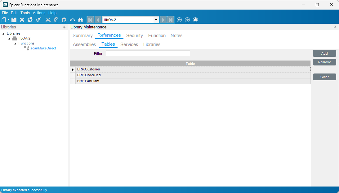

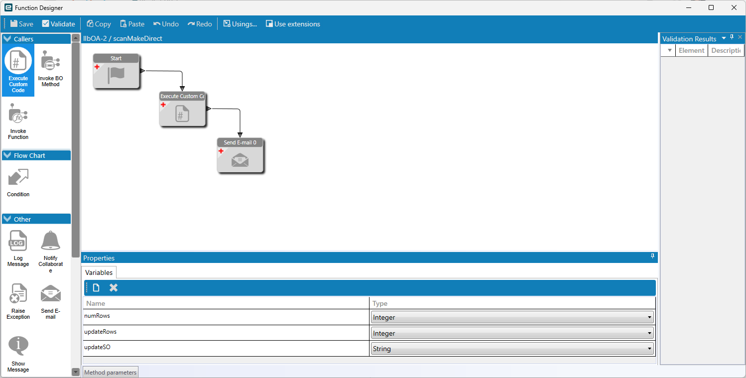

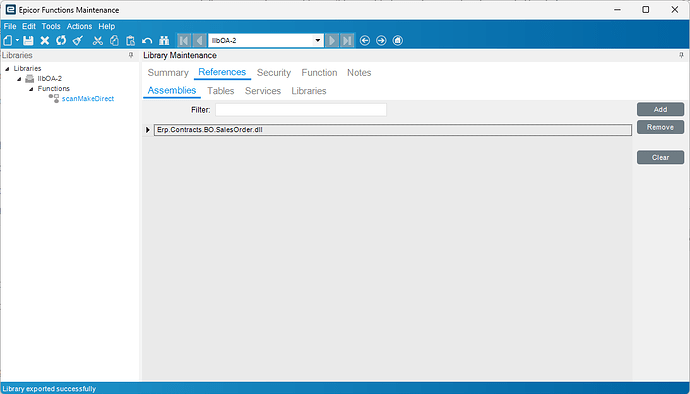

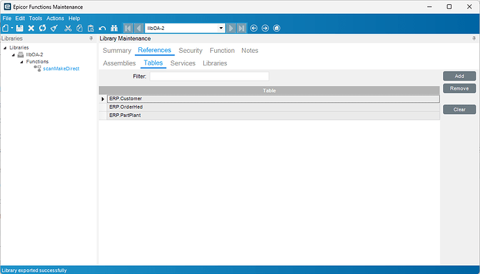

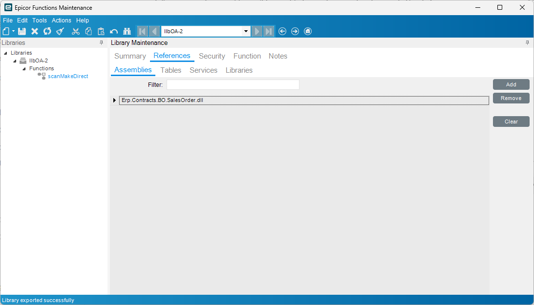

Would you mind sharing a few screenshots of how your Function is configured? Thank you!
I’m sure there’s a more elegant way to do it but it’s one of the first functions we did and never got back to it, lol
//  initial setup
string thisCompany = Session.CompanyID;
numRows = 0;
updateRows = 0;
updateSO = "Updated List:" + Environment.NewLine;
//  get direct ship customer number
int custNum =
    Db.Customer
        .Where(r => r.Company == thisCompany &&
                    r.CustID == "2"
        ).Select(r => r.CustNum).FirstOrDefault();
//  get open direct ship sales orders
//  check if any rows selected
var oh =
    Db.OrderHed
                    r.OpenOrder == true &&
                    r.CustNum == custNum
        ).ToList();
if (oh == null || oh.Count < 1)
    return;
//  rows selected
//  loop through releases and set make to false
this.CallService<Erp.Contracts.SalesOrderSvcContract>(bo =>
    try
        foreach (var row in oh)
            bool hasChanges = false;
            numRows += 1;
            //  get sales order
            Erp.Tablesets.SalesOrderTableset ts = new Erp.Tablesets.SalesOrderTableset();
            ts = bo.GetByID(row.OrderNum);
            if (ts == null)
                continue;
            //  review the Make flag and set to False
            foreach (var rel in ts.OrderRel)
                // skip if release is closed
                if (!rel.OpenRelease)
                    continue;
                // skip if already set to false
                if (!rel.Make)
                    continue;
                //  set Make to false and set warehouse to part primary warehouse
                rel.Make = false;
                rel.WarehouseCode = Db.PartPlant.Where(p => p.PartNum == rel.PartNum).Select(p => p.PrimWhse).FirstOrDefault();
                rel.RowMod = "U";
                updateRows += 1;
                updateSO += rel.OrderNum.ToString() +"-" +
                            rel.OrderLine.ToString() + "-" +
                            rel.OrderRelNum.ToString() + Environment.NewLine;
                if (!hasChanges)
                    hasChanges = true;
            //  commit the changes
            if (hasChanges)
                bo.Update(ref ts);
    catch (Exception ex)
        string exMsg = ex.Message + Environment.NewLine;
        if (ex.InnerException != null)
            exMsg += "Inner Details:" + Environment.NewLine;
            exMsg += ex.InnerException.Message;
        throw new BLException(exMsg);
        return;
    finally
        bo.Dispose();
Thank you very much!
I had to make a slight change to the CustNum assignment because our CustID isn’t 1 to 1 with our CustNum and ran into small issue with a couple of the open lines not being a having a part master which causes it to error out. These were open lines for things added after the SO was converted from quote such as freight or tax. I’ll either have to add logic to only update parts that have Part Masters or change our business process to only use lines with Part Masters. Either way, once I closed these lines and put it on a schedule to run immediately the other lines were all Make Direct = FALSE. Time Phase looked good too!
