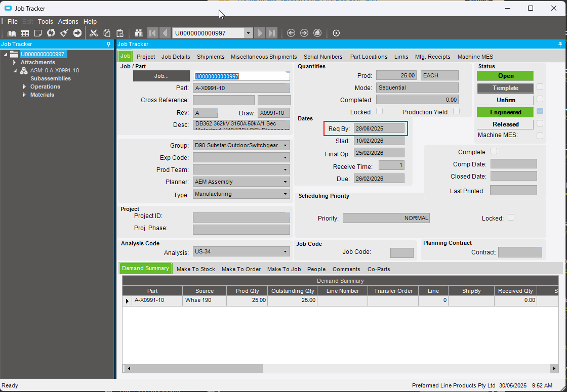

Epicor has run MRP and has created extra demand for a part. I tried to read the logs and it says that MRP is “expediting” jobs that are already firmed (which are locked btw so the schedule cannot realistically move and can confirm that did not move) and creating an unfirm job for the qty that is not on existing jobs (ie the balance)
Can anyone help me understand what happened here? According to us there should have been only a single unfirm job for qty 3 and the end balance should have been 0

09:40:34 Part A-X0991-10 has a receive time of 1 days and will be available February 26 2026.  It will not meet its required date of August 28 2025.
09:40:34 Done Scheduling job:U0000000000997 sending job to queue SaveLoad

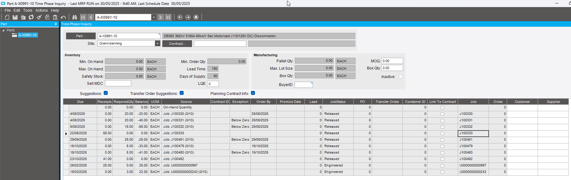

The required by date being calculated on the unfirm job matches the “expedited” job due date of 28/08/25, but it doesn’t make sense since this is not a demand but a supply. There is no demand on 28/08/25 for this part, as per what we can see in time phase.
Have you looked in the PartDtl table to see the records there? Do you have a Job Multiple set on the part? I saw inter-site in your log, do you do manufacture for other sites?
