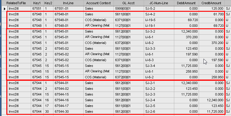

For example:
That shows 3 Invoices (67551, 67548, 67544, and 67544).
  • Invc 67551 has just 1 Tran GLC record. Because that’s all that was needed
  • Invc 67548 has 3 for Line 1
  • Invc 67544 has 3 for Line 1, 3 for Line 2 and 3 for Line 15

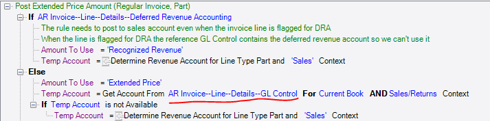

In this case the TranGLC of type A as calvin mentioned is for account information only, this is shown in a few Forms so you can specify GL Accounts directly using the EpiGLAccountEditor, this one is on the Line/Detail tab of AR Invoice Entry. You can see UserCanModify is true for the type A record.
This means this will be used in the posting rules instead of the usual rules(if you didn’t enter any account it will execute function “Determine Revenue Account for Line Type Part…”)
Once the actual posting engine processes the Invoice is will create the TranGLC record of the transaction, so it will be of type R and will contain amounts, this is the information that is used if the invoice is later referenced by other posting processes like paying the invoice or cancelling the invoice.

RuleUID must match the actual booking rule that generated that TranGLC record, for example in my previous post the rule is named “Post Extended Price Amount(Regular Invoice, Part)”
