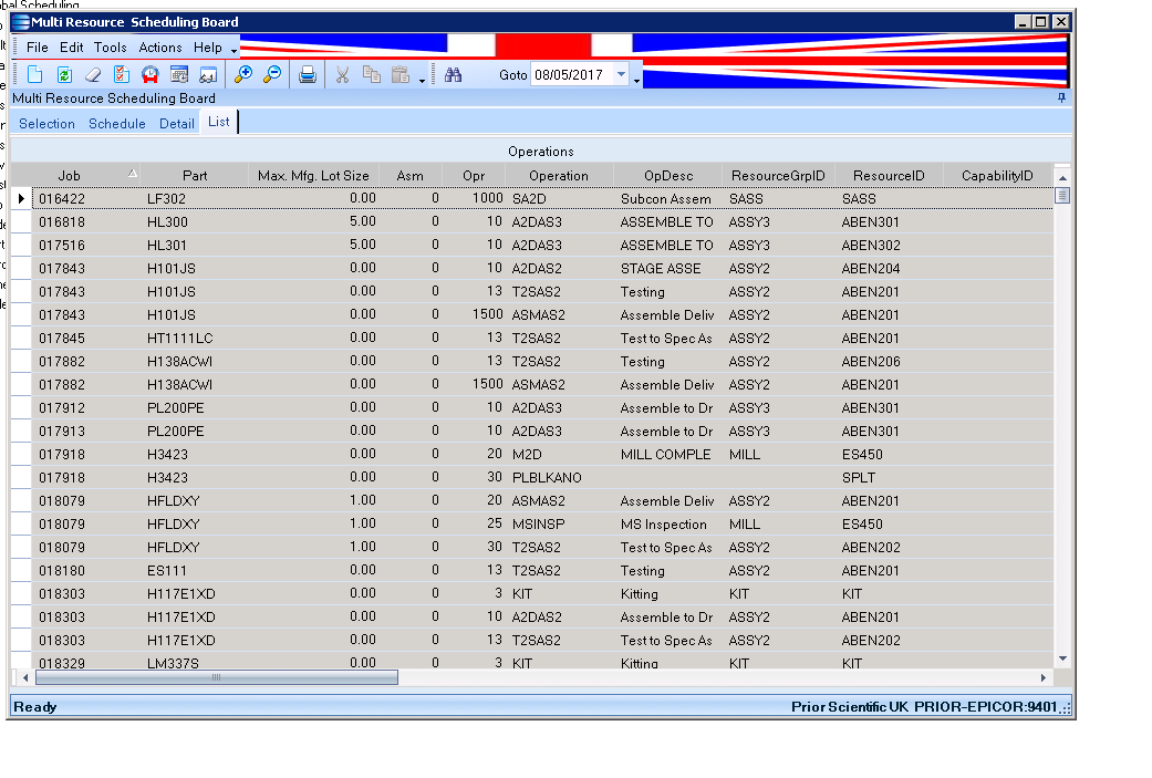

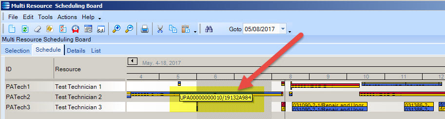

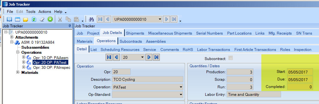

I checked our MRSB and it does show unfirm job, per screenshot. Do you have start and stop dates on the operation that is using the resource (screenshot 2)?
Nancy

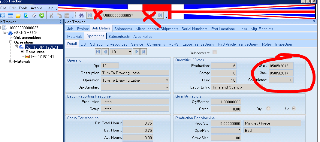

Hi Nancy,
Thank you for your reply, the unfirm jobs are still populating in Job tracker, so i’m able to do a screenshot of your request.

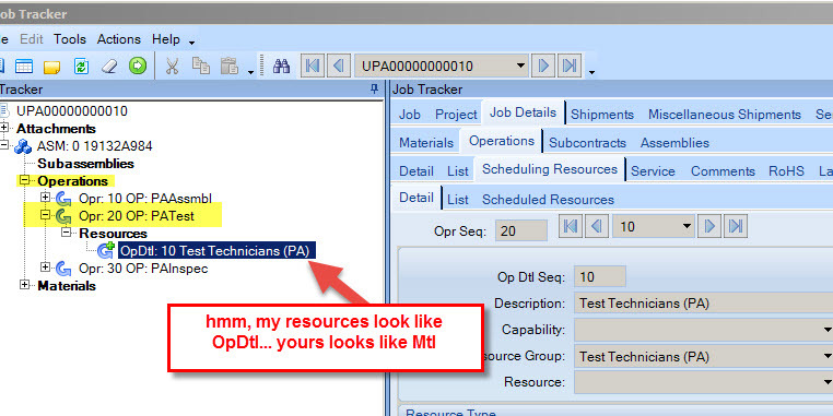

In your first screenshot, I don’t see R1141 as a “pulled in resource” for your MRSB… when you searched and brought in the multiple resources for showing on the scheduling board, did you pull in the R1141? I’m sorry if this is a stupid question, but I do silly stuff sometimes and maybe others do too
Also, i noticed my Job Tracker shows the resource as OpDtl, but yours doesn’t. Is there something special about your resource here?
Nancy

He doesn’t have his Resources expanded (notice the + sign next to Resources) and you do. The material that is showing is that, a material used for that operation.
I was going to ask you what dates you are using to view it. The default Start Date appears to be today and the job you were looking for was last Friday
