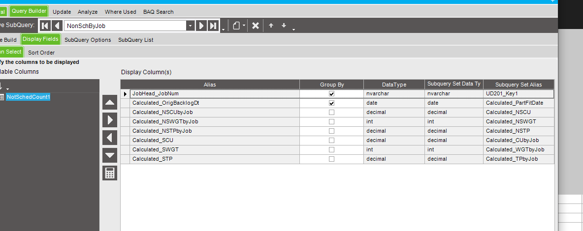

I am having issues getting any results out of a union query.

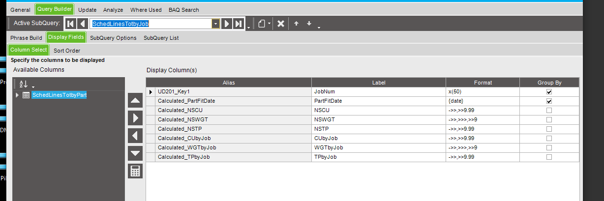

Hi Mike,
Any chance the nvarchar and the x(50) on the Key is causing the problem bringing them together? Maybe make the nvarchar one a string with 50 char and then put it together? Just a thought…
Nancy
You my friend are a savior. I matched the nvarchar character widths and it worked THANKS!
