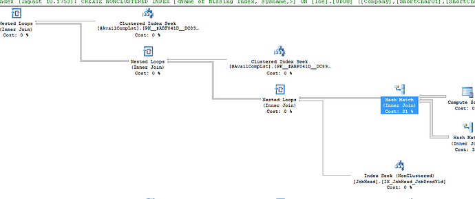

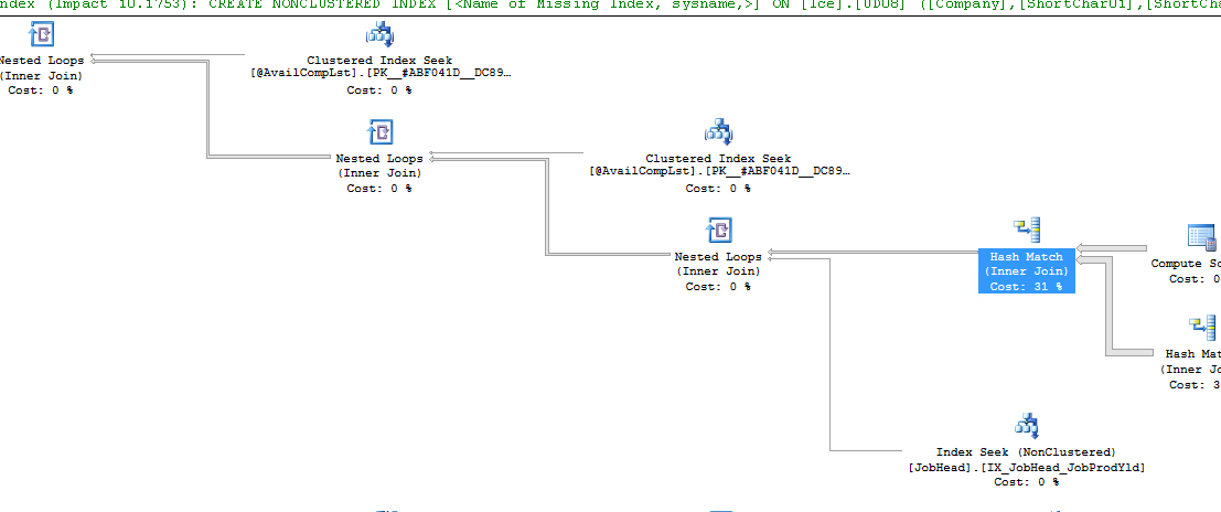

So this Hash Match at 31% is the highest one. The next closest is a 14% and 10% both clustered indexes. What can I do with this information?
The green text at the top of your screenshot is the recommendation. There is probably the option to create the missing index using a script that it’s already prepared for you.
How do I add an index to a BAQ?
You don’t, you add the index to the table/ db

So basically what this is saying to do? Create the index. How does E-10 know to use it then? Does this new column show up in the BAQ editor? Or do I have to make this an external query to make it work? Sorry about the dumb questions, remember I’m a manufacturing engineer, not an IT guy/software developer…

The stuff in green in the execution plan is the ā€œscriptā€ you need to run to create those indexes. (just give it a better name than

You might have been able to get this to work with the index on the ud table. I am guessing what we did just leveraged a different index. The plan will tell you more. Have you checked out the execution plan in toad?
That’s what I did. I added the index on UD08
I tried, but since toad doesn’t like the calculated fields, it wouldn’t give me a plan with the SQL copy and pasted. I tried to adjust the SQL but don’t know enough to be able to get it to work. I also tried to open the plan from Epicor in Toad, but it doesn’t know how to read that either. I just looked at the plan in MSSQL server.
