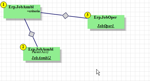

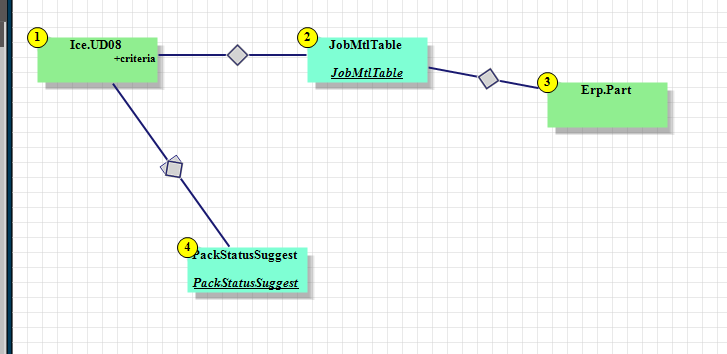

Yeah, for the most part I think. This is the one for the the assemblies
This is the one for the materials
Then the union is joined to a UD table which has the job number, assembly sequence, and material sequences as key 1 2 and 3.

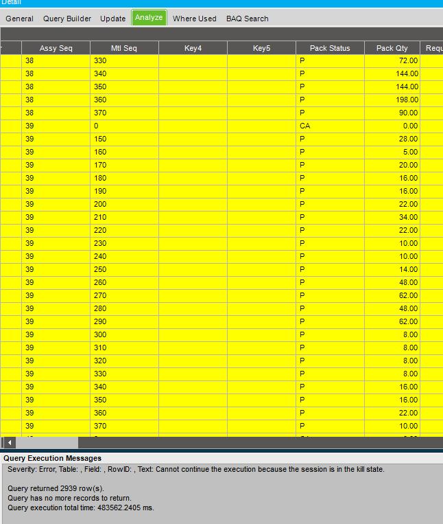

It just ran for over an hour, then I killed it and it shows 2939 rows and says it’s can’t continue because it’s in kill state.
any tips on how I read this? I had to change the extension to txt because I couldn’t upload .sqlplan to the website.
