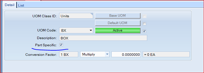

Set UOM to Part Specific, so each part can define its CS or BX in this case.

If the CS uom has been used as the 1 to 1, you will have to unset the has been used flag to be able to change.
