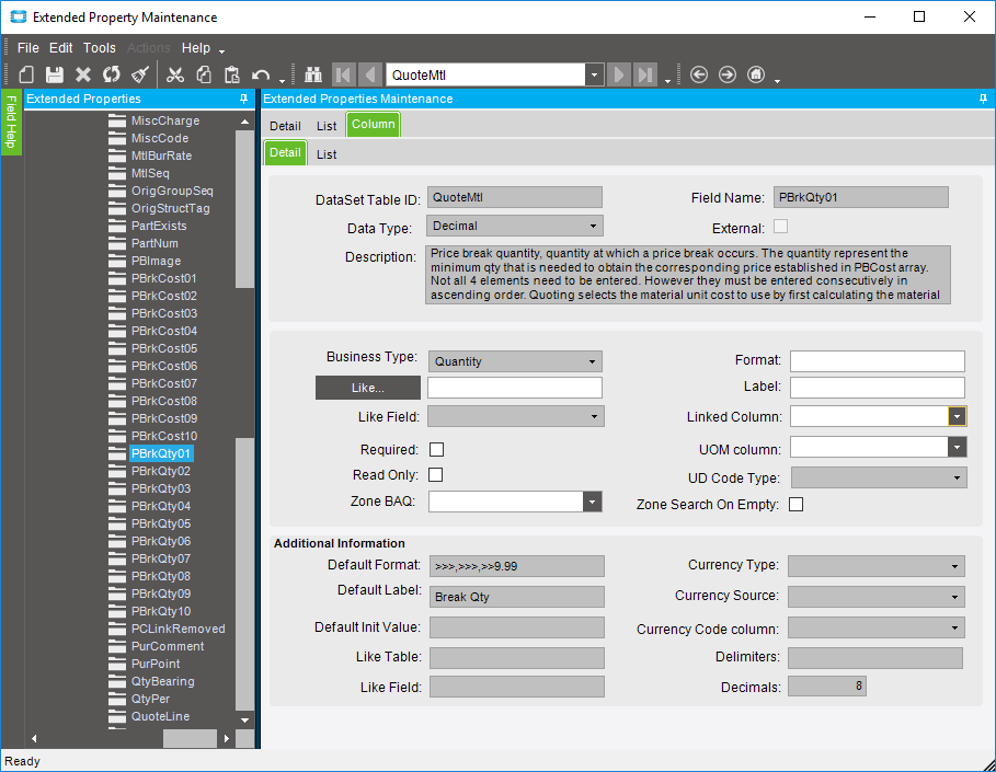

I unhid the QuoteMtl.PBrkQty01 field in Quote --> Line --> MfgDetails --> Quote Details --> Material --> List through a personalization.
By doing so, it forces QuoteMtl.UOM to move with it.
How can I break that behavior?
I know if I want to add that behavior, then I can do so in the Extended Properties, but the linked column field is blank.
Anyone have any thoughts on this?

Price break quantity, quantity at which a price break occurs. The quantity represent the minimum qty that is needed to obtain the corresponding price established in PBCost array. Not all 4 elements need to be entered. However they must be entered consecutively in ascending order.
Quoting selects the material unit cost to use by first calculating the material Required Qty based on the quote quantity. Then searches the PBQty array finding the element which is less than and closest to the required qty.
If one is found then the corresponding PBCost is used else EstUnitCost is used.
Estimated Unit Cost. May be defaulted from the appropriate Part master cost fields. Quoting allows multiple unit costs to be entered for quantity price breaks via PBQty & PBCost arrays. The price break logic considers the EstUnitCost field as the lowest element in the price break structure. That is if you had price breaks for quantities of 100, 500 and 1000. Then the EstUnitCost would represent the cost if the required qty is 1 - 99.

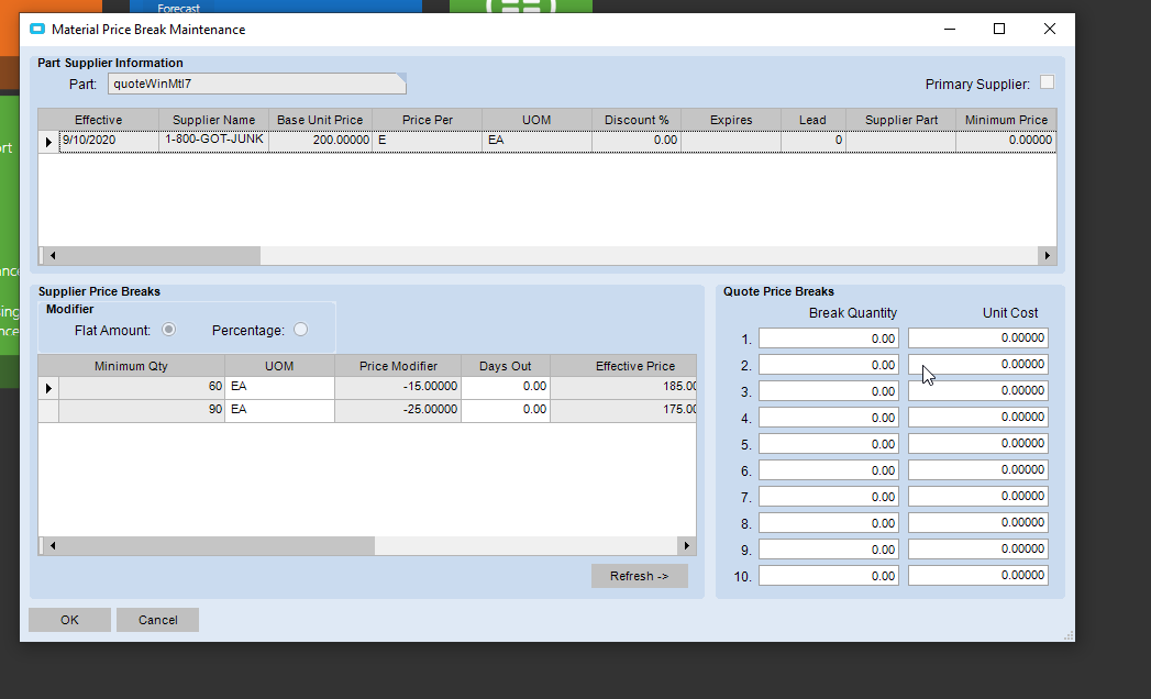

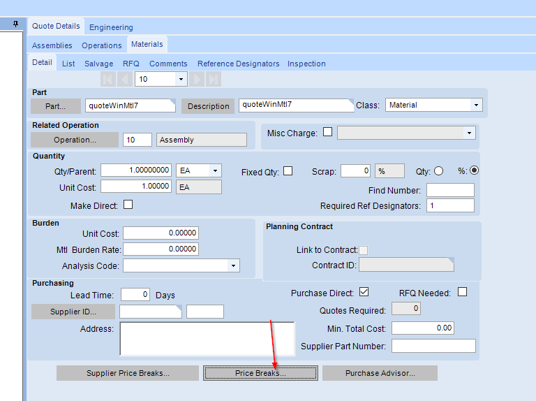

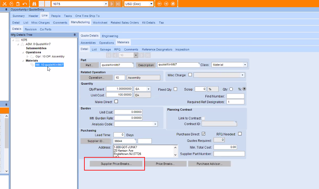

The Supplier Price Break (button)
Is to setup the supplier price breaks
While the Price Break button (lets you pull from those supplier price breaks into the material line) which is a Cost Break to us not a Frigging Price Break…
And its a stupid name it should be a Cost Break not a Price break.
