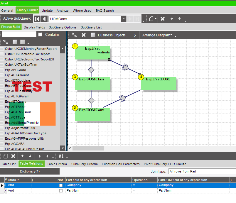

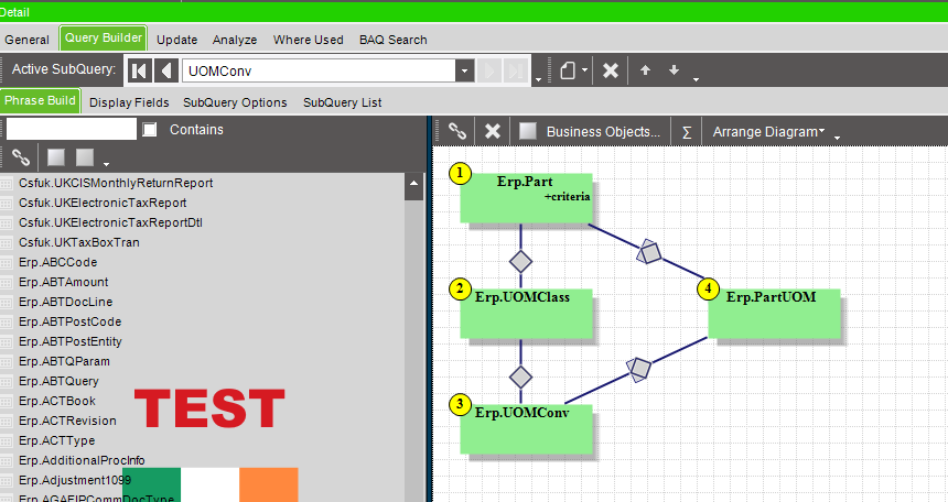

One subquery for the conversion (you can probably get rid of the part table there):
with the following joins:
Part.Company = UOMClass.Company
Part.UOMClassID = UOMClass.UOMClassID
UOMClass.Company = UOMConv.Company
UOMClass.UOMClassID = UOMConv.UOMClassID
Part.Company = PartUOM.Company
Part.PartNum = PartUOM.PartNum
UOMConv.Company = PartUOM.Company
UOMConv.UOMCode = PartUOM.UOMCode
You will have 3 calculated fields there:
ConvFactor = (case when PartUOM.ConvFactor is null then UOMConv.ConvFactor else PartUOM.ConvFactor end)
ConvOperator = (case when PartUOM.ConvOperator is null then UOMConv.ConvOperator else PartUOM.ConvOperator end)
NewFactor = (case when ConvOperator='/' then (1/ConvFactor) else ConvFactor end)

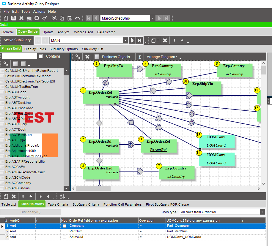

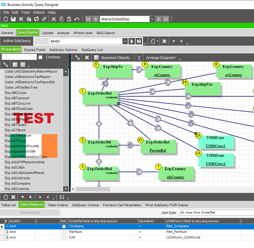

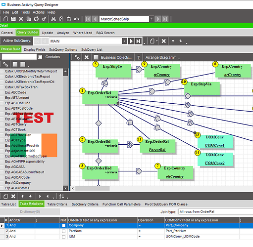

Then, in your main query you will use the subquery above 2 times, just like mentioned above (ignore everything except tables 1, 13 & 14, it’s an old query back from E9):
IUM to BaseUM:
BaseUM to SalesUM:
Finally, to get the qty’s in the new UOM, use this as a formula in your main query:
NewQty = (PartWhse.OnHandQty) * UOMConv1.Calculated_NewFactor * (1/UOMConv2.Calculated_NewFactor)

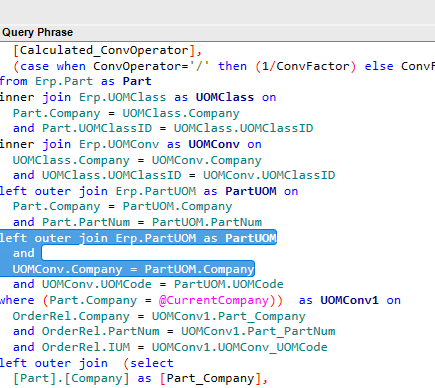

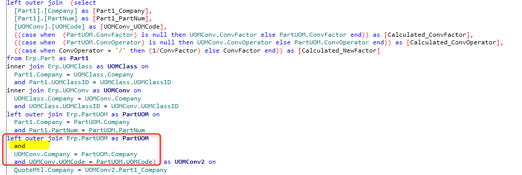

Hi Dragos,

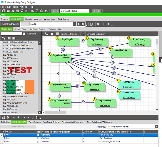

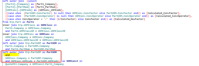

Thanks for the information. I had some issues with the UOMConv, joining Part to PartUOM and then UOMConv to PartUOM. the first join is fine, but the second join doesn’t work out in BAQ designer, the join is missing the ON keyword and replaced with an AND
@JasonMcD thank you, it’s good to be here!

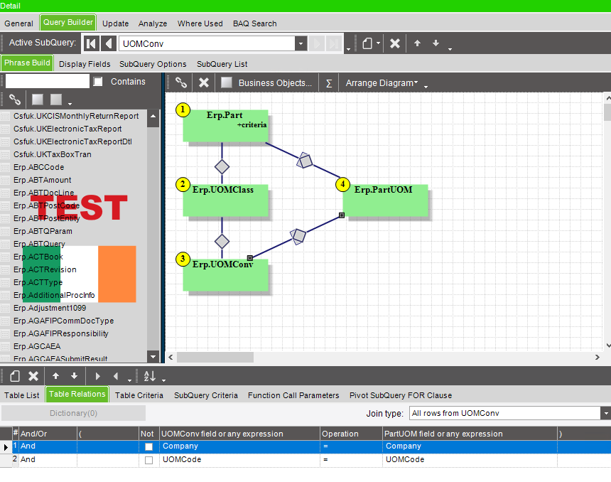

@mchernecki that’s weird, looking at your version and at the image I think something went wrong with your query. Maybe try to start from scratch ? Or if you have a backup of it somewhere.
I have them as simple joins, nothing special about them:
LE: mine looks the same and I don’t have any errors:
Dragos
Hi Dragos,
All good, I redid the BAQ from scratch and now it works. Thanks for your help.
