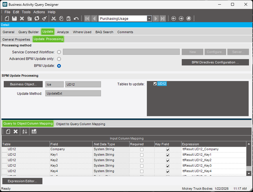

I’m trying to create an updatable BAQ and updatable dashboard. When I try to create a new record or update an existing record within the dashboard, the changes don’t save when I reopen the dashboard. I need to update and add new records to the UD12_Key1 field while maintaining constants for the Company and the Key2 fields. Can anyone diagnose this issue?
In the uBAQ what method are you using to update the UD table?
I used UpdateExt method.

Looking at your video, your BAQ has both Key 1, and 2 as mandatory, but your form is only pushing key1.
Yes! I missed that part too! For fields that need to change, use any non-key field. Your key fields must be static once the record is created. You don’t need to use all the key fields.
