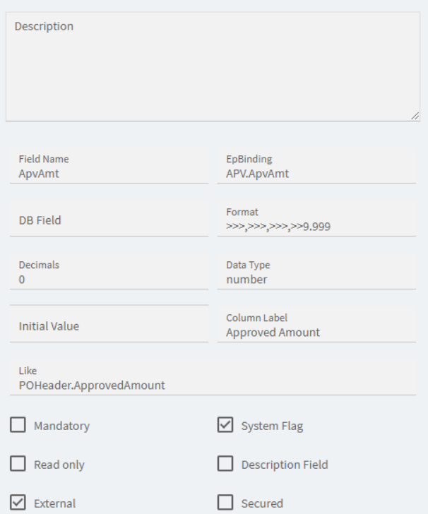

When reviewing the PO Approval form, the ‘Approved Amount’ field is greyed out until the user selects Approved. However, the Approved Amount field is not a DB Field that I can easily update.
My thinking is that my UBAQ needs to recognize the ‘Approved’ change for the PO, and then somehow get the ApvAmt to match the POTotal, but how do I update the ApvAmt?

You need to include the POHeader table in your query as the ApprovedAmount field is in that table
I did have this field in my query but I did not understand how to interact with it, or if it only updated after the PO Approver manually entered the approved amount on the PO Approval form. I just performed a little testing and may have a path forward.
