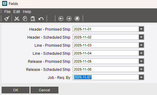

I have an updatable BAQ which allows updating the requested by date and Need by date on Order Header, Order Line and Order Release and also allowing updating on the Job Required Due Date. I have written custom code to update all 4 tables but something is not working correctly after clicking update in BAQ Designer.
Field Editor
Updated Fields in Analyze Grid
Field after clicking update

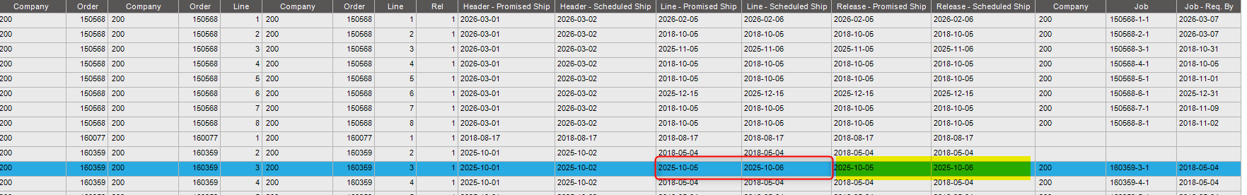

The line release dates are writing to bothe the Order Line and Order release. How?

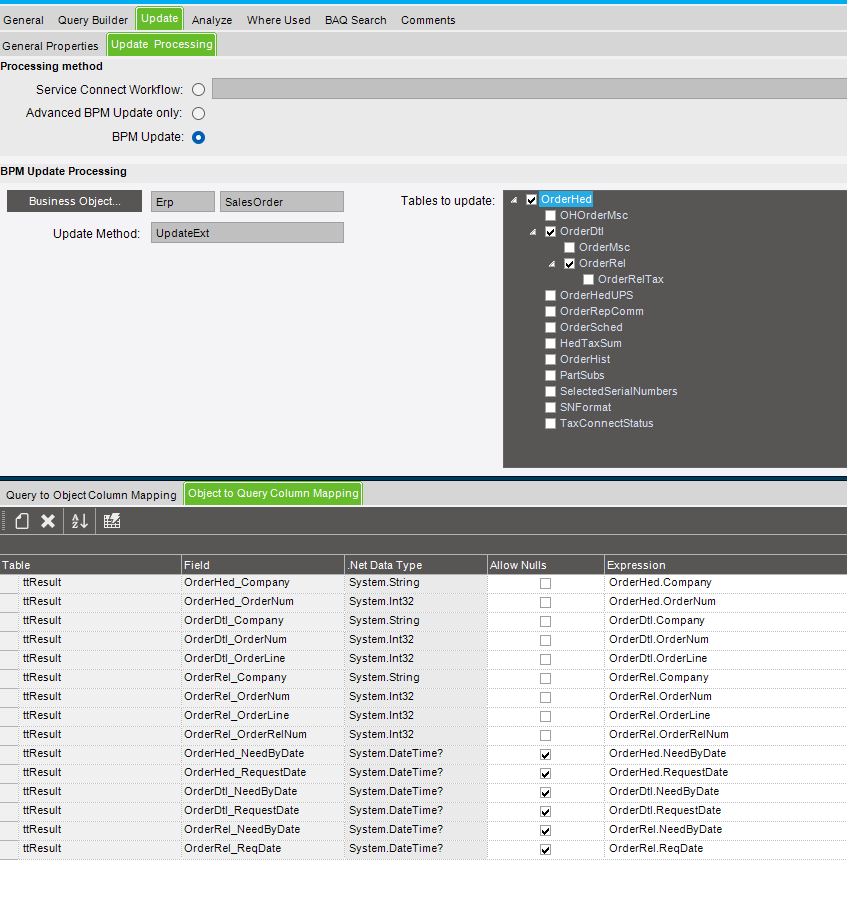

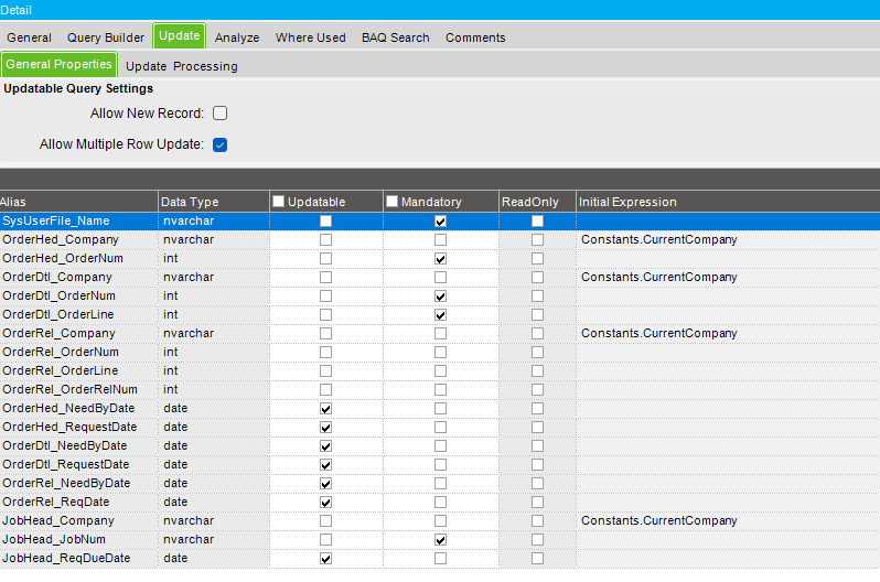

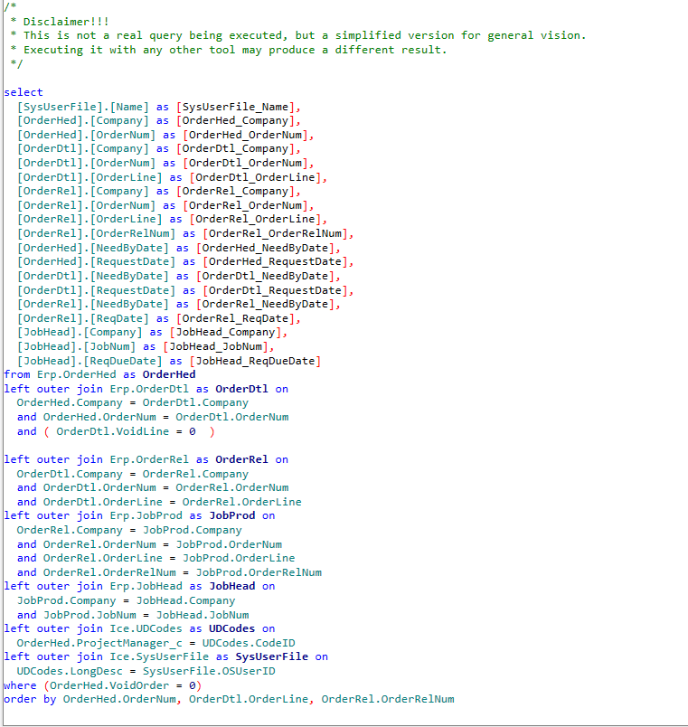

Not sure what is going on here. I changed the updatable BAQ to use the default BPM Update processing. It is doing the same thing (order release dates are updated to both the line and release, so it wasn’t my custom code. Can anyone see anything wrong with my query?
BAQ
Update - General Properties
Update - Update Processing
Analyze grid

Thanks for the suggestions. Most of those I had already cleaned up on my own.
I moved from TEST to our PILOT system and wrote a simple BAQ with only the OrderHed, OrderDtl and OrderRel tables. Then made the RequestDate and NeedByDates updatable at all three levels, using the builtin code, no custom code. Same results, the dates from the release get updated to both the Line and Release fields. Any ideas?
Here is an export of my latest simplified BAQ that is doing the same thing.
vawTest1030.baq (31.1 KB)
