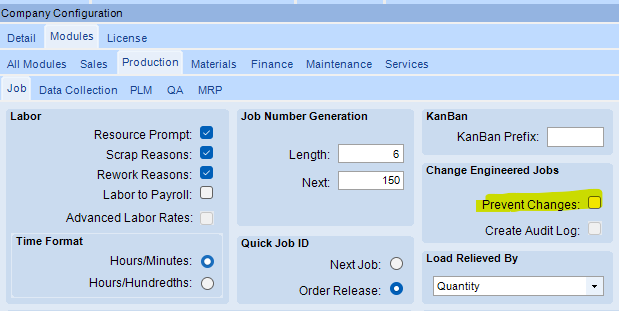

Well, one “easy” solution is to uncheck this checkbox in Company Config (which I’m assuming must be checked in your case):
BUT… I cannot speak for your organization’s wants/needs and whether this is acceptable. Someone, or someones, chose to prevent changes to engineered job in your company configuration, but I at least wanted to bring it up.
Hi David,
Yes I found that one this morning and tested it. It unlocks far too much for our liking and it turns off the audit log which we really need.
