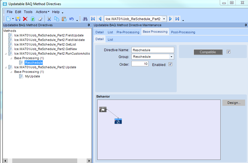

I have an updatable dashboard which I have imported from our Test environment into Live and now the Run Custom Actions is not working. The Update part fires ok but then nothing. I put some message boxes into the BPMs which is how I know one is working but the other is not. Can anyone suggest what the most likely cause is? I have tried everything I can think of but no luck so far.
This is a long shot, but RunCustomAction requires a dirty (changed) row.
