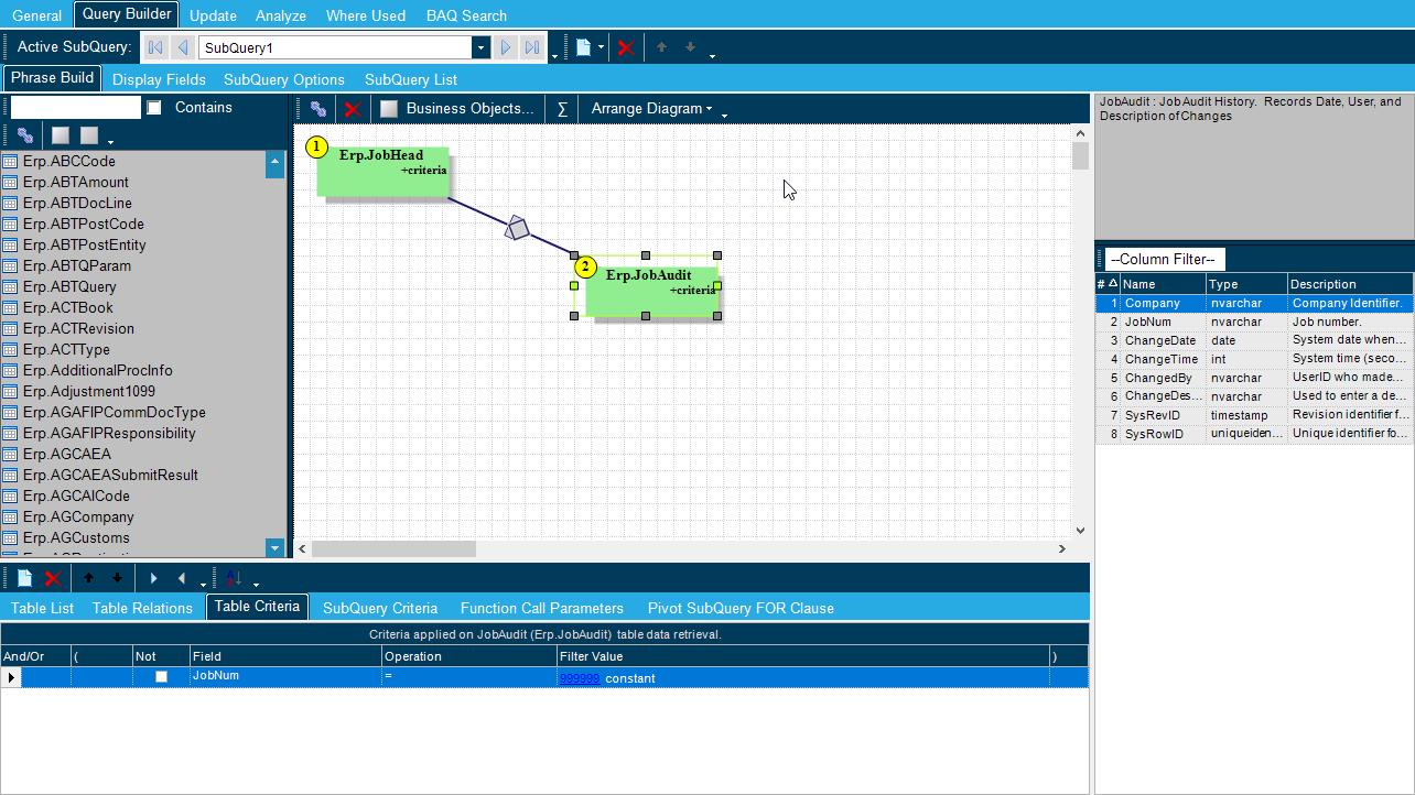

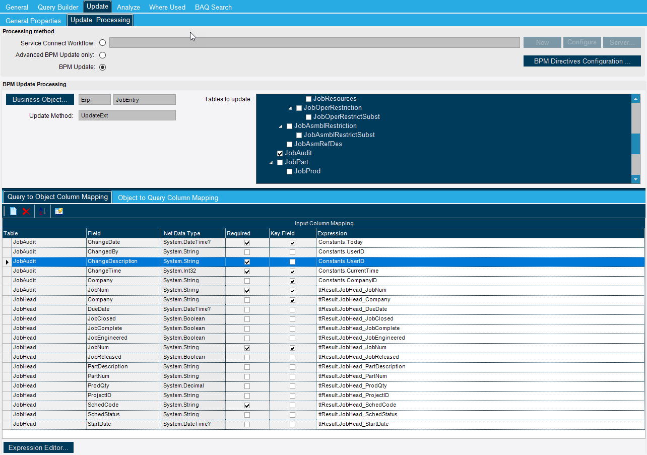

I am trying to create an updatable grid for users to change a couple things on Jobs and I can’t get it to save because we have auditing turned on and it is asking for a change description. If you go to Engineer and Release a job it needs the Audit change description. I have tried adding the JobAudit to the BAQ with no luck. I can’t get it to take a change description. Any ideas?

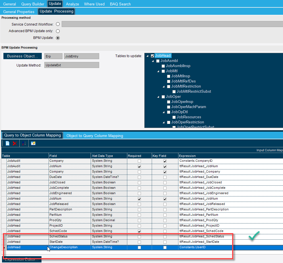

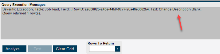

Figured it out … It kept saying JobHead ChangeDesription was empty but there is no JobHead.ChangeDescription, at least I didn’t think there was. I tried to add it to the ‘Query to Object Column Mappings’ and it was in there:

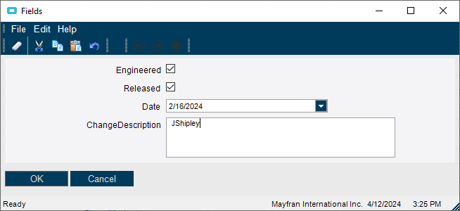

Now it works!
I just set it to the user ID which is good enough.
