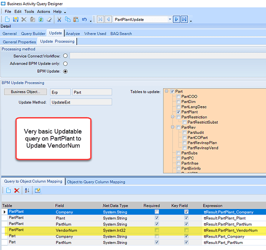

Good Morning,

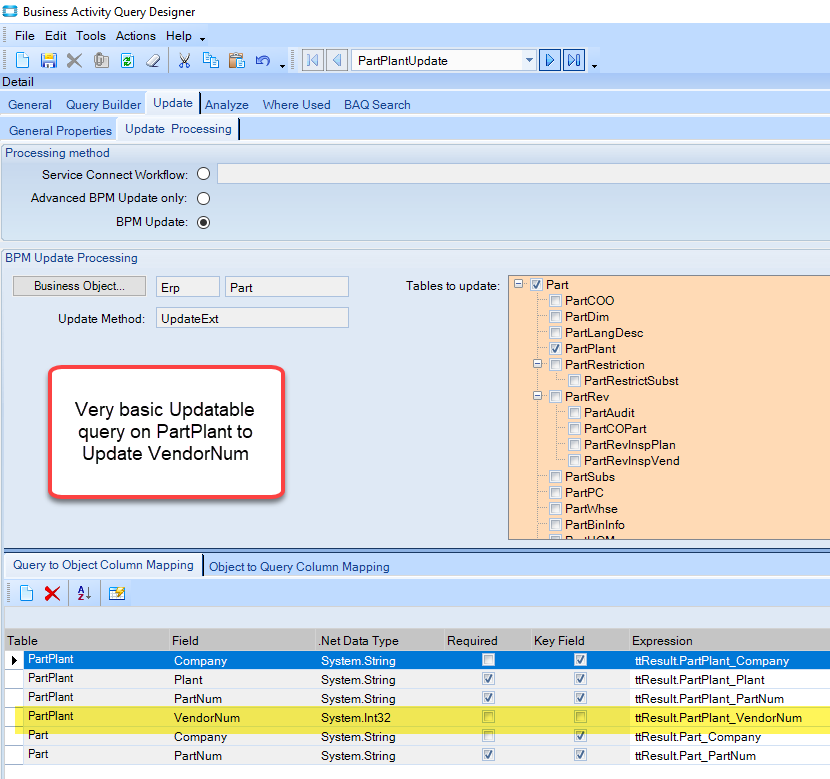

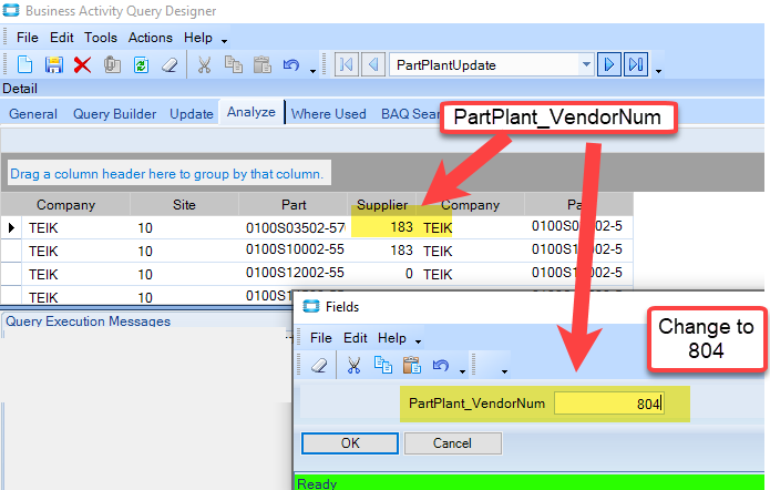

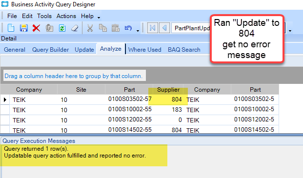

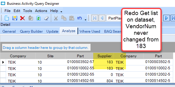

I am driven bonkers by this updatable query. Can someone throw some ideas about how to do a workaround to get this working as needed/expected? I have simple UBAQ below, it’s for PartPlant vendor number update. See screenshots. System claims its doing update but does not do it. How can I force the VendorNum change into the field as needed? I’ve messed with BPMs within the UBAQ a little here and there and I wonder if there’s a way to do this. I suspect it’s a bug in my version…

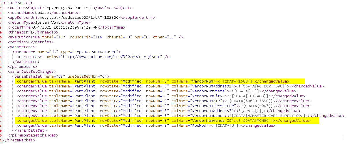

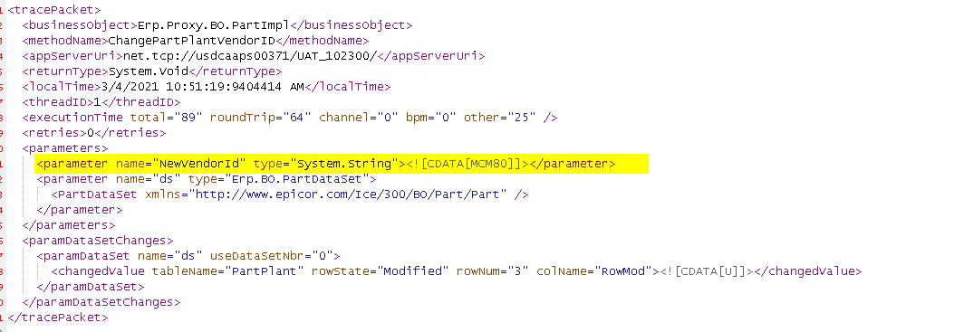

A trace of manually changing the Vendor on the Part-> Site sheet reveals:
(I think this was the call made when I typed in the new VendID, and it looks up the Vendor info)
and this is the actual update.
Note that it includes a column name VendorNumVendorID Which is what DMT would use…

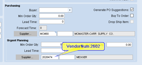

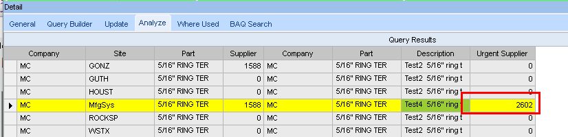

Hmmm … If I add the column PartPlant.UrgentVendorNum and make it updatable, it can update the Urgent Vendor field on the Part->Site.
Processing update on:
yields

I’ve:
  1. Added the Vendor table
  2. A calc column named VendorNumVendorID (which is just the VendorID)
  3. Made Calculated_VendorNumVendorID updatable

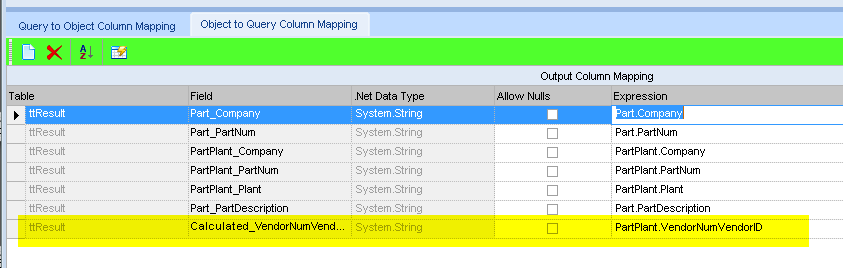

  4. Added a row to the output mappings:
And that saves and runs with no errors, but still doesn’t update PartPlant.VendorNum
I’ve even tried setting both PartPlant.VendorNum and the VendorNumVendorID fields to see if that would then update but still no luck.
Also tried just updating PartPlant.VendorNumVendorID with VendorNum being un-updatable. Still fails.

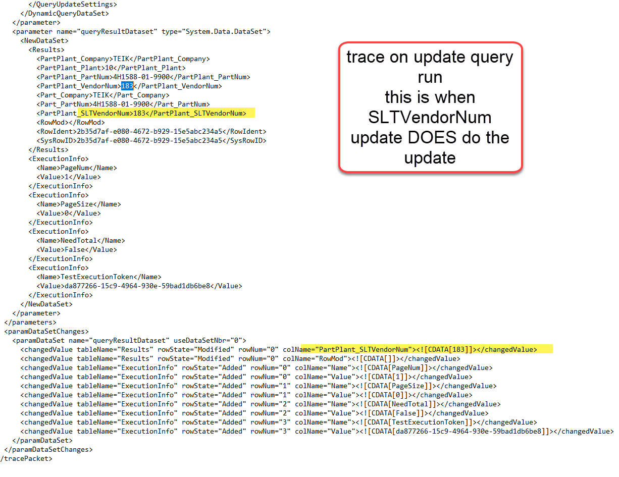

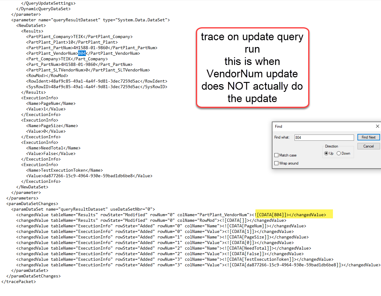

I ran the trace on the updatable BAQ for when the VendorNum update fails VS the SLTVendorNum is successful. The darn thing, they are both the same from what I see.

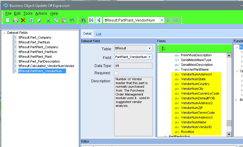

If I launch the Expression editor for the output fields, I see all the pseudo-fields from the trace in my first post.
Perhaps they need to be set as well. Or maybe just the RowMod field needs updating
