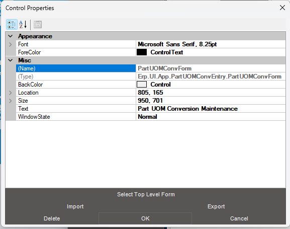

You would have to do a personalization to show it in the list grid of the uoms.
Do you recall what the check box wasDo you recall what I need to do here? Been a minute since I used classic.
called?
It is part entry which is just part. go to the uom tab then list. click on the grid then open collection you will see the has been used is checked as hidden. Uncheck that click ok then save the layout.

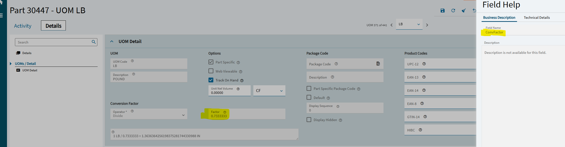

Weel In my version is is now read only

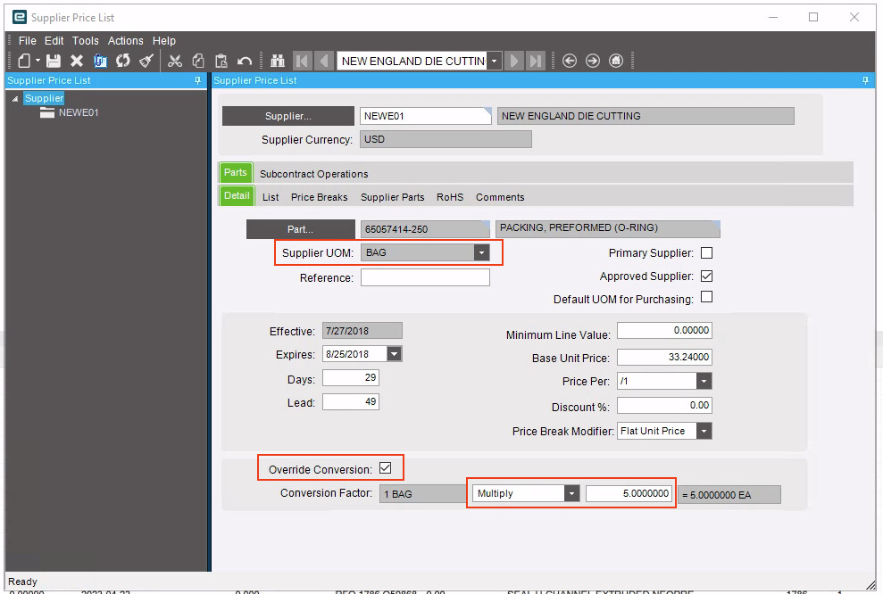

Unfortunately, once the unit of measure conversion has been used on the part, the conversion factor is locked in. That said, you can override it by using a price list. Setup a price list for the Supplier(s) from whom you purchase the part and there is an Override Conversion checkbox. This resets the conversion factor for that part when purchased from that supplier. I only have access to a 10.2 form right now, but here is what that looks like.

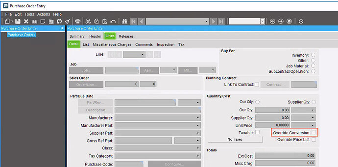

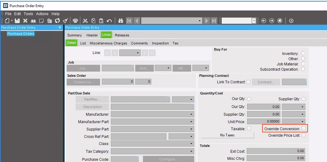

Likewise, the conversion factor can be overridden on the PO Line…
…but the user has to remember to make the change. The conversion change on the price list will default on the PO Line when the part is purchased from the Supplier.
