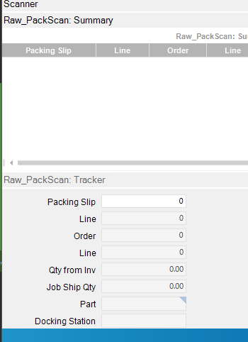

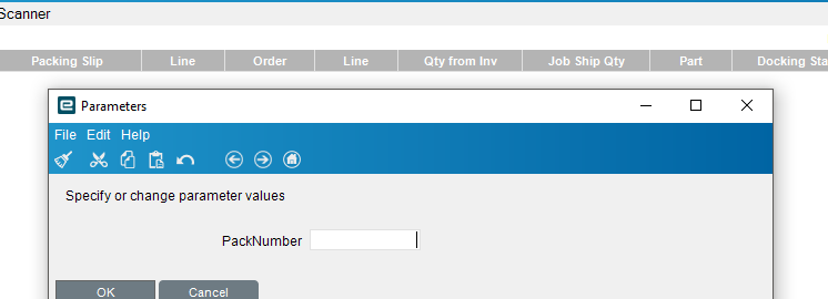

What I’m trying to accomplish is: We have packslips (printed paper) with the packnumber that is barcoded, we then have an employee scan that barcode, that will then have a prompt always available dashboard to receive the scanned packnumber (see image) which will then update a field (probably UD field) within the ShipDtl table with the datetime stamp or the same pack number.
[barcode scanner will be set to hit F5 (refresh) after scan - or may need to programmatically make the prompt available for entry again]
I’ve tried several from event type and I’m not able to trigger my test message box when I input a packnumber via barcode scanner.

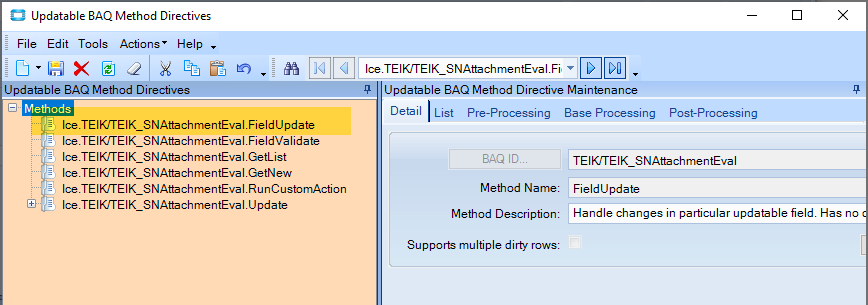

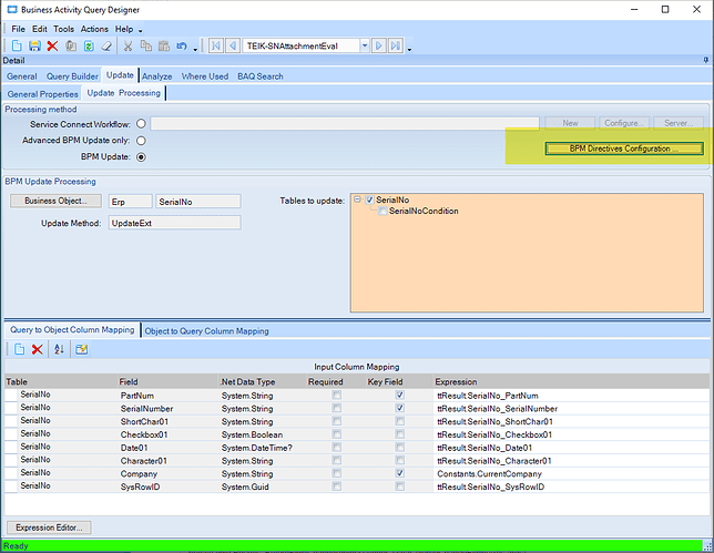

Are you using an updatable dashboard based on an updateable BAQ? If so, could the BPM directives configuration on the updateable query help get you where you need to go with field update? I have found these useful for making default settings when user has entered data into updateable dashboard…

I was thinking maybe Field update… Put a condition that it’s running on the pack number update and then use bpm to set your UD fields as needed.
