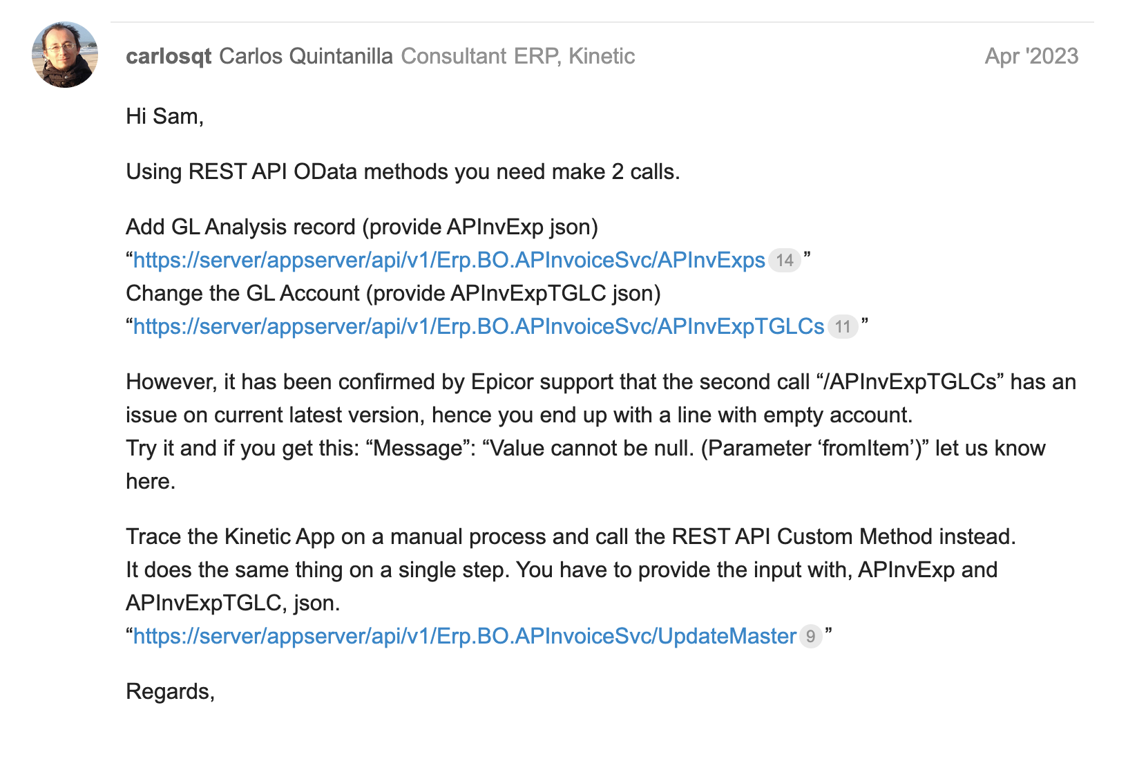

My Question: Is there a specific method that I need to invoke when working via BPM/Function to get the GL Account to stick? I tried to do something similar to what @carlosqt mentioned in the screenshot below, but could get none of those runs to work properly, they were leaving amounts off the invoice and it was still landing in suspense. I’m out of ideas. It seems like no matter what it is either overwriting whatever GL I pass in with suspense or the account doesn’t stick and it defaults to suspense.
