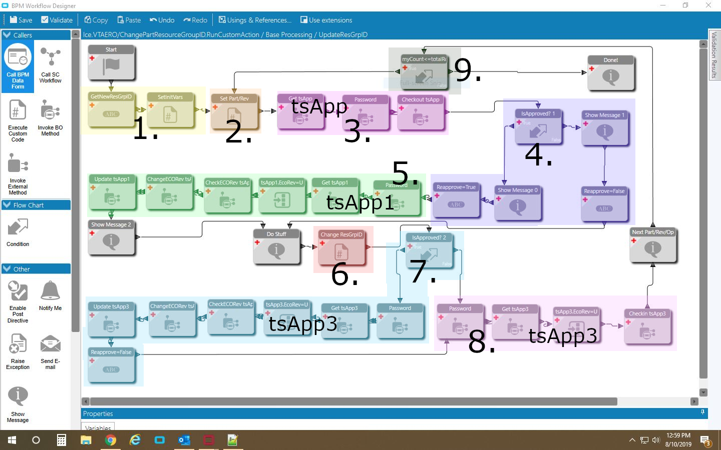

Once the BAQ returns the list of part/rev/ops to update, the BPM takes over. For testing I click the RunCustomAction button. Working through the workflow (attached):
- Set some initial variables.
- Get the part and rev from the next BAQ result row.
- Check out the part to my mass update group, “MU”.
- Check if the part is approved, if so set a flag so we can reapprove it later.
- If part was approved, unapprove it.
- Change the resource group id for the matching part in the mass update group in the ECOOpDtl table.
- If the part was previously approved, reapprove it.
- Check the part back in.
- Loop back to the next line in the BAQ results.

Right now, my problem is at the first Update method, “Update tsApp1”. Here I try to unapprove an approved part after it has been checked out into my mass update group.
I get the error:
“Update not allowed to visual representation of PartRev record.”
The confusing part is that I don’t think I am trying to update the PartRev table directly, so one of the methods must be tapping into it.
