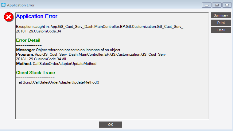

I get this error.

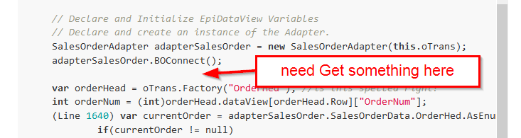

You are creating a new adapter you need to get a hold of the current adapter instead.
You connected your BO, but you never got a new or existing dataset. You’ll have to do that somewhere in your code.

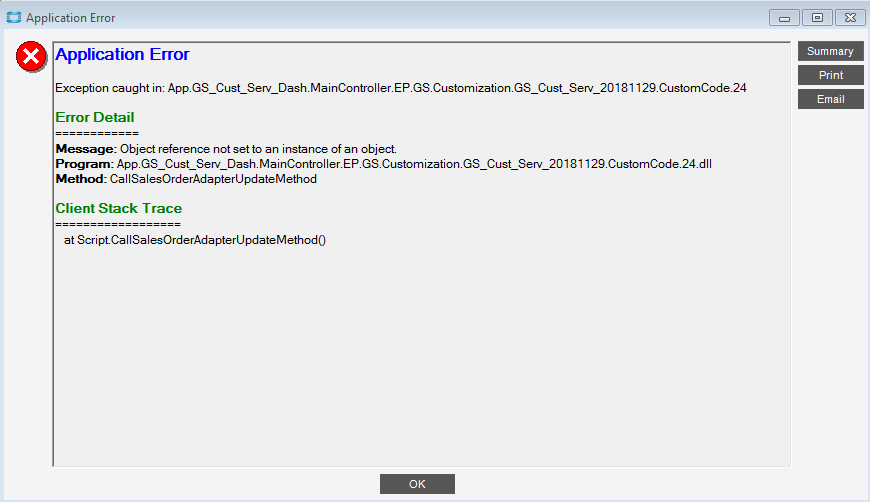

Okay, I changed that. Now I’m getting this error:
I put in some message boxes to help. I got to the “2nd Step Sales Order Update” and then this error came up.
