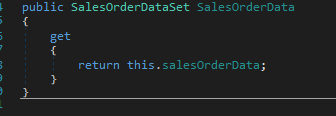

You put SaleOrderDataView in there. It should be
adapterSalesOrder.SalesOrderData.OrderHed[0].OTSName
All adapters have a DataSet that is generally AdapterTypeName+Data:
SalesOrderData
CustomerData
CustShipData
etc

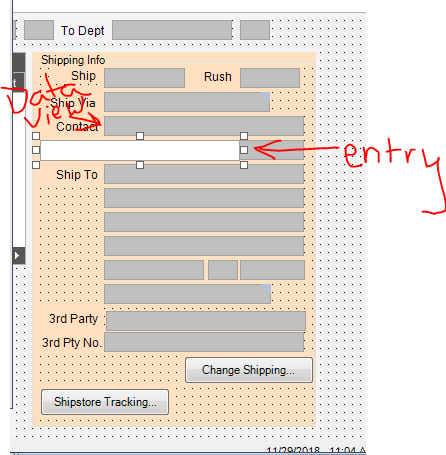

Okay another question. I can’t actually change the text box that is bound to the data view because it is read only and it won’t let me change it. So I was entering the new data into a different text box. How do I tell it I want it to update with that text box?
Depends on what the textbox is bound to, but I’d try setting the dataview value rather than the textboxt text
Okay, sorry guys. I’m an idiot. My goal is to be able to click a button and have customer service change a Ship to name and then click a button and update the Sales Order Record. On the image above the one marked Data View is attached to the DataView and I cannot change it to be editable. So, in order for Customer SErvice to be able to enter what it needs to change to I was going to have this text box pop up, they enter the data there and then save and I take that data from the text box and update the Sales Order.
