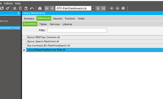

I added the following assemblies to my function, but this hasn’t helped. I am not sure how to add get the update to work and send the API key as part of the Invoke BO Method.
