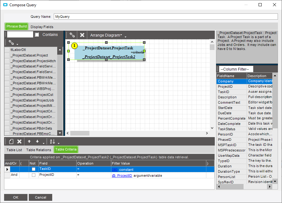

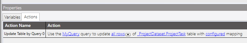

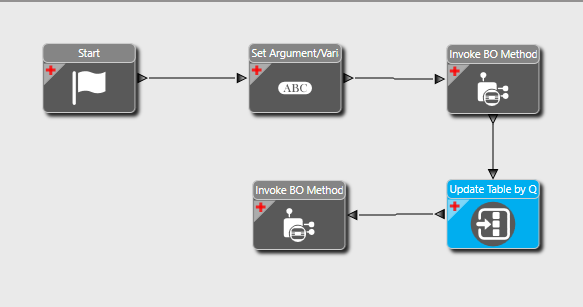

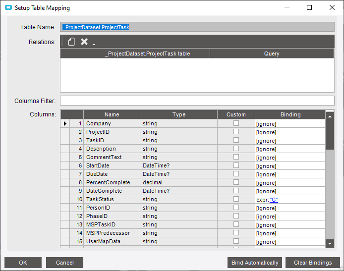

Ok. So here is what I have so far…
  1. I save the ProjectID as a variable ( _ProjectID )
  2. Get the Project by using my variable, and then returning the dataset as another variable ( _ProjectDataset )
  3. Update my dataset (This is the tricky part for me. Is the configured mapping the values that I am updating to? So like in SQL terms… Set [field] = value)
  4. Invoke the Update BO.
My Update Table settings…
How am I doing so far?

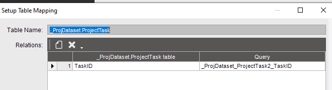

Got it working! Thanks! I just had 1 step left to do. I missed adding the Relations at the top of the mapping window…
