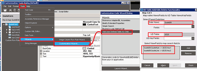

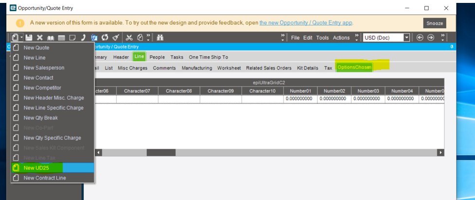

I am still using classic forms. I have made a custom sheet on my quote screen called ‘options chosen’. I also placed an epiUltraGrid on the new sheet that is binded to UD Table 25. The key 1 is quote Number and Key 2 is quoteline. I need help on the proper code to use in the UD configurator method entry screen to essentially tell it that
Inputs.epiPcTextBox8.Value = Character01, Inputs.epiPcNumericEditor33.Value = Number01, Inputs.epiPcNumericEditor34.Value = Number02 etc for over 20 inputs.

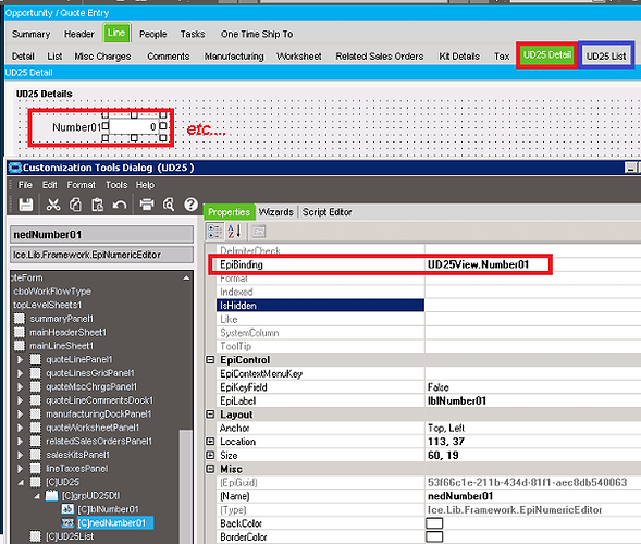

It looks like you used the wizard to add a UD Child?
And then added a sheet with a gridview that is bound to UD25… i.e. list view?

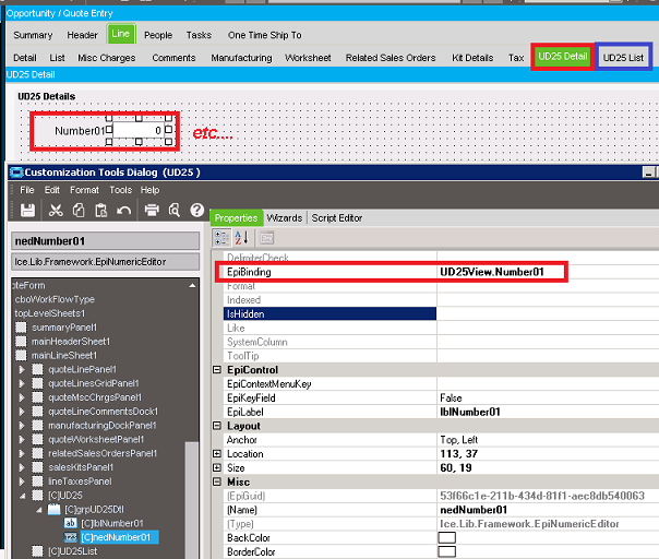

Can you simply add a second “detail” sheet with controls that are bound to your UD25 fields?
Or are you trying to do something more complicated?
Yes, I did use the wizard. All of the controls are inside the configurator. I don’t know how to code the on save in the configurator designer method to populate those fields in the UD 25 table
We’ve not done it like you are doing it, we added UD fields to QuoteDtl and do it like this. Does the UD25 table show up in the target entities list in the Document Rule Expression Editor? If it does, then this method should work for you too.
