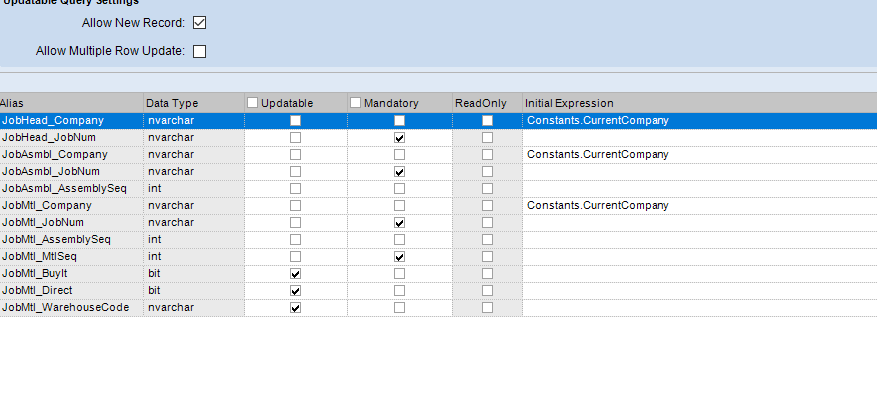

is this what you want to see?

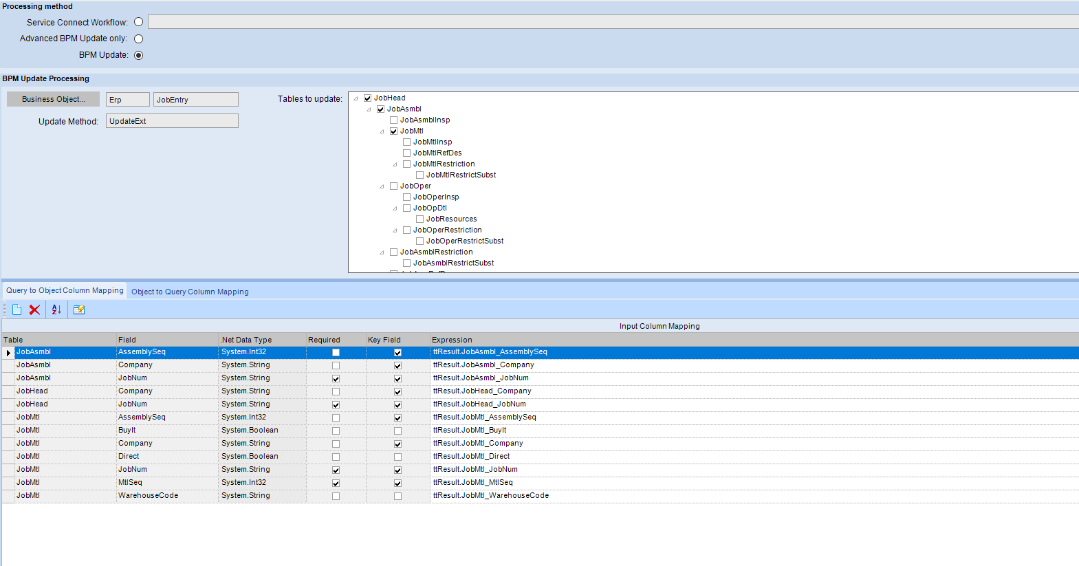

Yes, that looks ok, how about the tab Update > General Properties?
Keep in mind it works on other fields just not the buyit field
I reproduced your issue on my end. I setup the simple UBAQ to update the buyit field. Although the BAQ editor returns no error, the field is not updated.
I’m confused as to why because I can update it on the Job no problem.

  1. Add a bit calculated field to the Updatable BAQ named dspBuyIt and in the expression set it equal to JobMtl.BuyIt
  2. Move to Update > General Properties
  3. For field Calculated_dspBuyIt check Updatable.
  4. Move to Update > Update Processing tab.
  5. In the Query To Object Column Mapping click Expression Editor.
    File > New
    Table = JobMtl
    Field = dspBuyit
    Expression = ttResult.Calculated_dspBuyIt
  6. File > Save
  7. File > Exit out of Expression Editor
  8. Move to Object to Query Column Mapping tab and click Expression Editor.
    File > New
    Table = ttResult
    Field = Calculated_dspBuyIt
    Expression = JobMtl.dspBuyIt
  9. File > Save
  10. File > Exit out of Expression Editor
  11. Move to Analyze tab.
  12. Click Get List button.
  13. Double click on a row to update and check dspBuyIt.
  14. Click Update button
  15. Click Clear Grid
  16. Click Get List to confirm that the record was updated.
