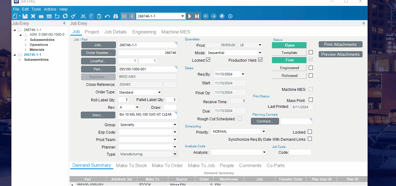

Apparently… I had the wrong client open…
Our scheduler just knocked on my door and said ā€œI am a man of constant sorrow, wtf man?ā€.
Yep, I did your example in Production. Fun times. :rofl:
