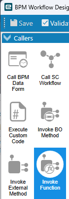

Can you encapsulate that in a Function and then call the function from your directives?
Maybe…
Honestly, I haven’t begun to play with the function functionality within Epicor. This probably gives me a good excuse to start digging into it. Now to just figure out where to start.
Start at the beginning…
Thank you for the link, Mark.

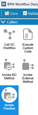

You can call Functions from Standard Data Directives
and Method Directives
I was gonna suggest the same. It’s mostly what I do now. Put the selection and glue code in the directive, and the main logic in a function.
You gotta make judgement calls sometimes though because it’s definitely not a one-size fit all solution.
Kinda my goto now though.
