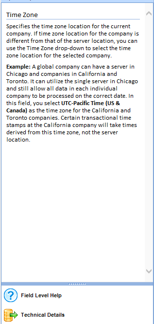

In a effort to not have our schedules change when daylight savings time happens I set the timezone for our companies in company maint. This morning I came in and setting our company in the UK to the proper timezone, caused clock in times to be 5hrs ahead of when they actually clocked. Wouldn’t recommend setting this field, no idea why it would have done that to clocked time. The field help for the field is not very helpful either.
I believe that setting has to take into account where the App Server is. Most people that are On Premises, most likely have the server in their HQ/Main location. So there’s no diff between the local users and the app server.
So this setting doesn’t take into account the local time on their computer at all? Seems like the Site timezone setting might do this, but not the company setting. Frustrating this is even something to hassle with try to figure out every time the clocks change and then you end up messing something else up. I’ll just deal with a broken schedule and fix it every time.
