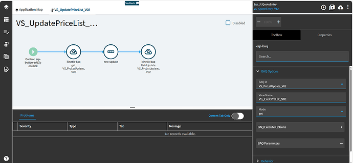

To achieve this, I created a UBAQ and built a DataView using that BAQ. In the event (triggered by the button click), I:
  • Pass the required line as an input parameter.
  • Use a row-update and a Kinetic BAQ widget to update the BasePrice field in the PriceLstParts table.

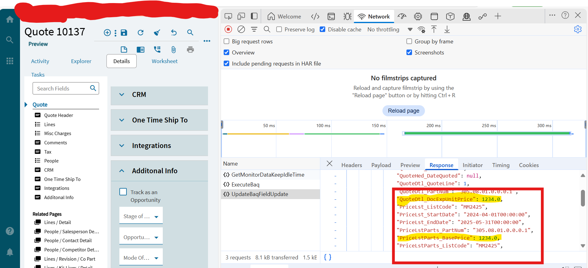

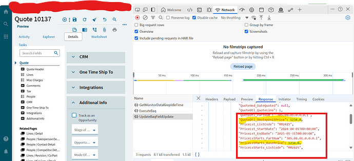

Now, the issue:
When I trigger the event, the Network > Response tab in the debug console shows that the BasePrice is updated correctly with the unit price from Quote Entry. But when I check using a BAQ, the BasePrice value is not updated.
If anyone has faced a similar issue or has any suggestions on what could be going wrong, please share your thoughts.

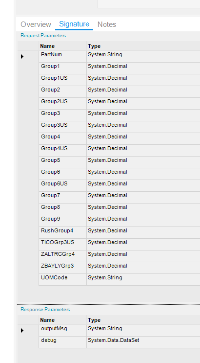

My ‘Signature’ on the function to assist with readability:

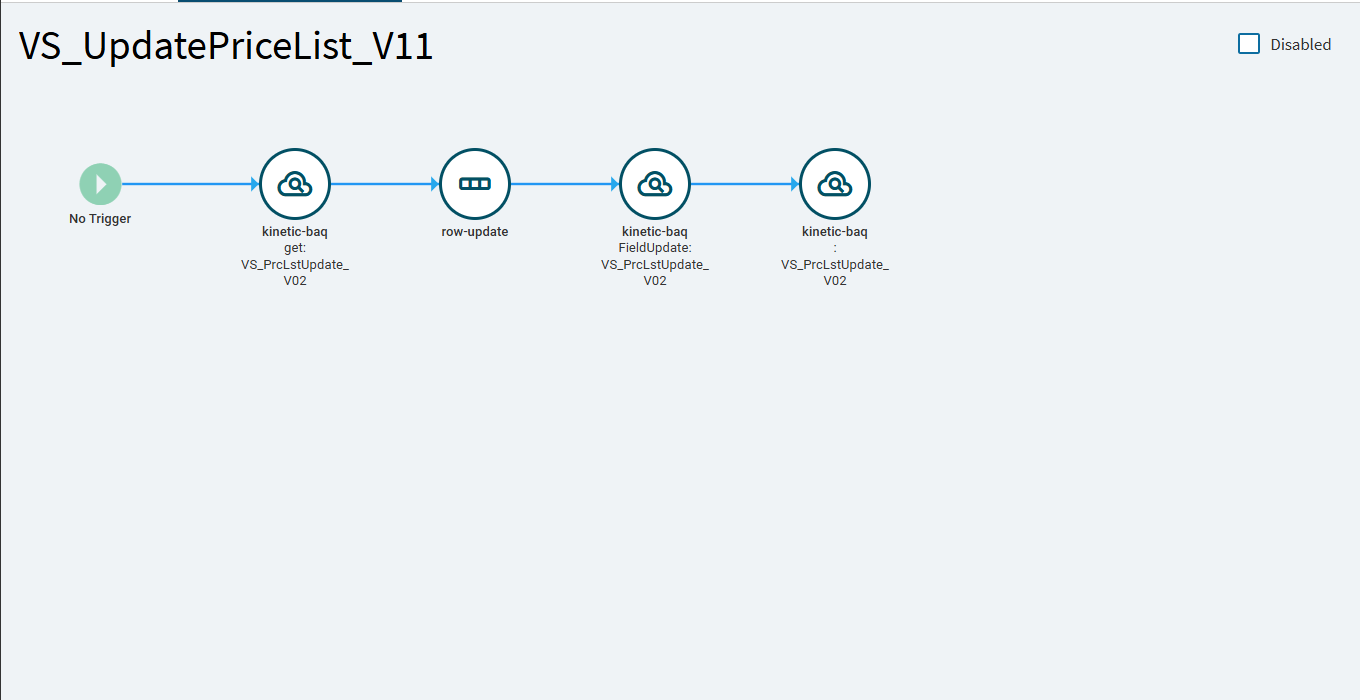

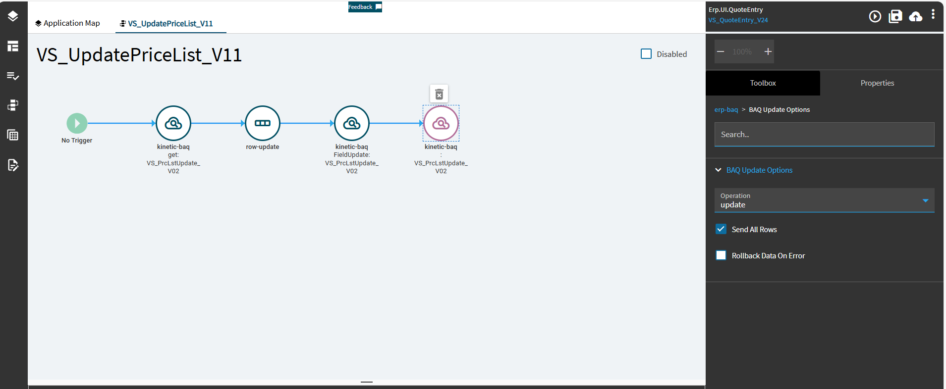

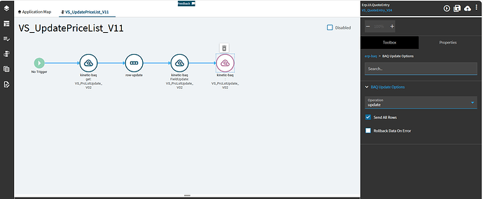

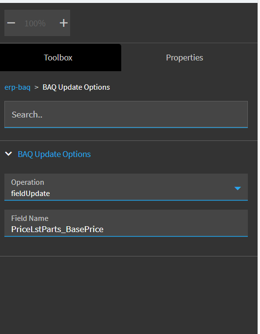

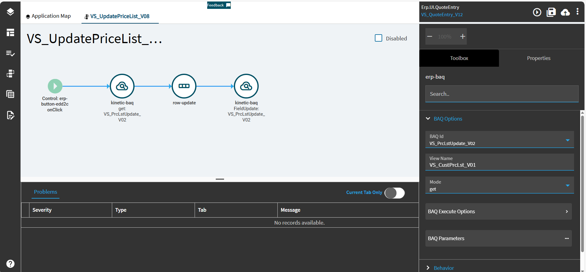

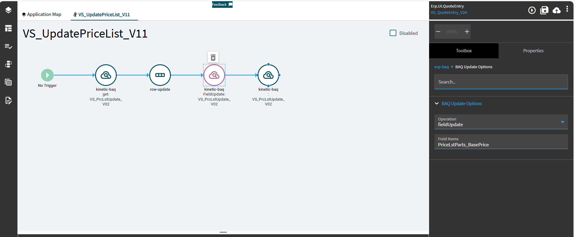

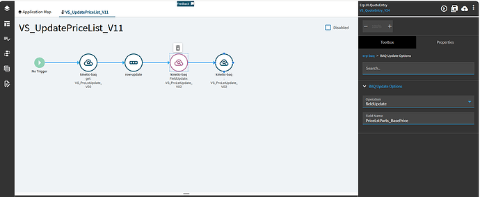

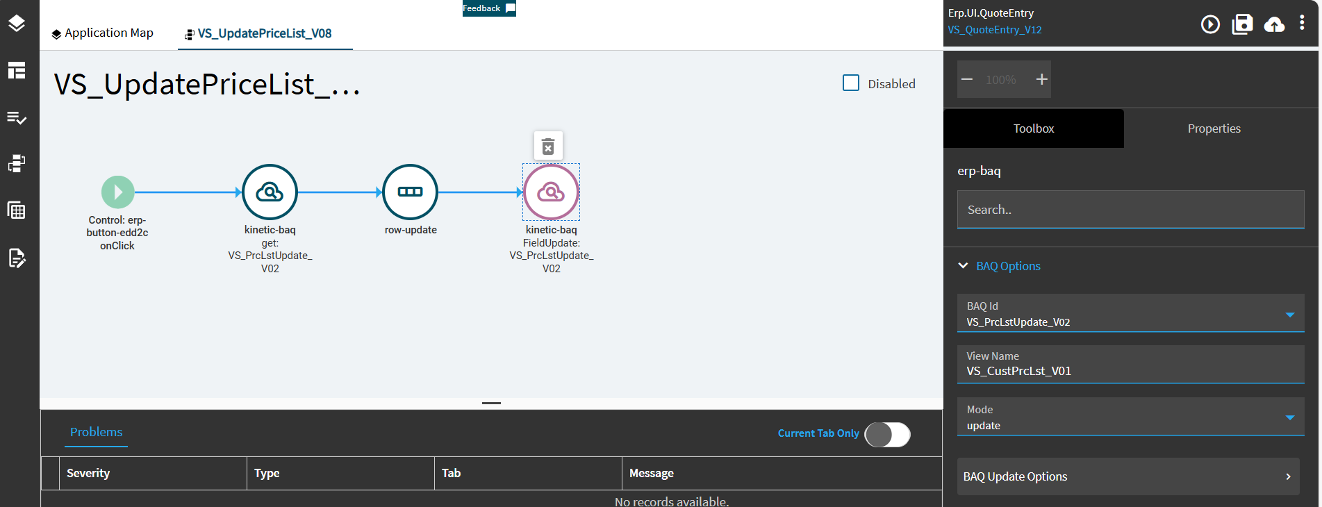

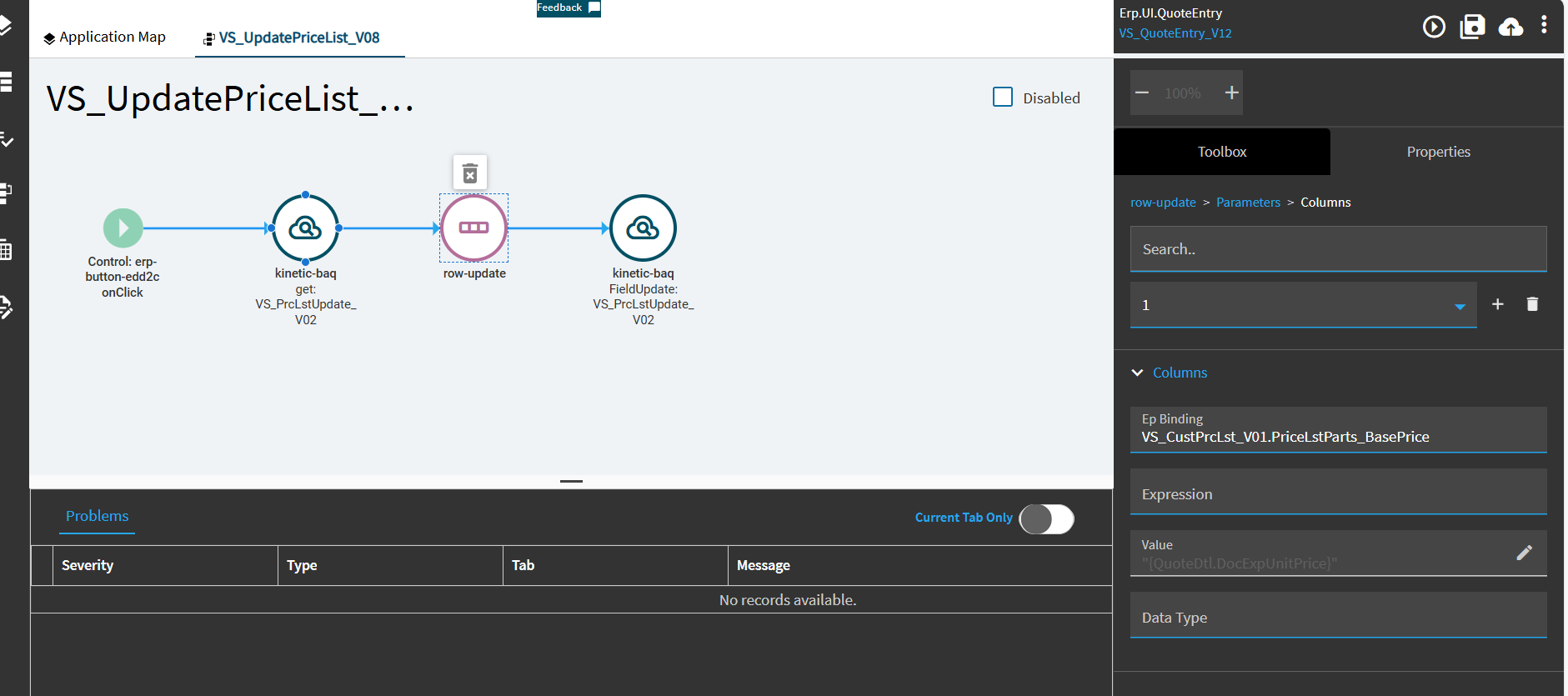

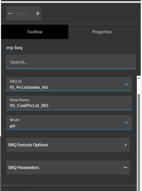

Hello EpiUsers,
I was able to resolve the issue I was facing. In my event, I modified and appended the BAQ Update widget, which successfully solved the problem.
Please refer to the image below for your reference.
1st BAQ Update widget. Updating only field
2nd BAQ update widget. Updating whole BAQ
Kindly check.
